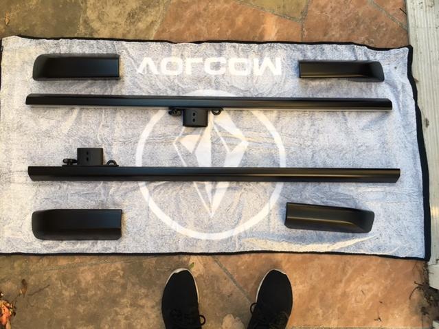

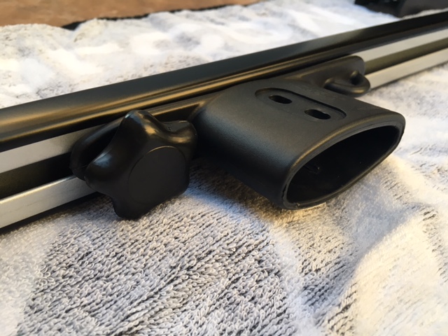

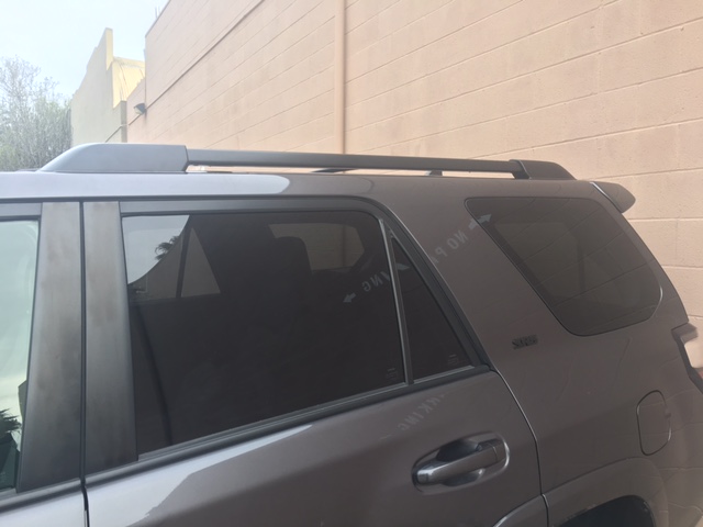

I had the roof rails and end caps of my 2105 SR5 wrapped in 3M 1080 Series Satin Black. I had doubts about choosing satin over matte but I'm really glad I went with satin. The 1080 3M Satin black is more matte than it is gloss; exactly what I wanted.I removed the silver roof rails from the black mounting brackets along with the end caps ahead of time so it would be easier for the installer to wrap. I also specifically asked to leave the channel open so I can move my OEM crossbars freely for any roof/ski rack. I left a slider from the OEM cross bars on each roof rail when I handed them to the installer so he could measure where to start/stop the vinyl.
When reinstalling the rails, I wrapped thread seal tape around the white nipples in the truck body, that the mounting brackets bolt to. This was probably over cautious (especially because I live in So. California) but that is a weak spot for a potential leak into the cabin. A silicone bead around the bottom would have been ideal.
I attempted to add pictures but this being my first reply/post, I probably botched it, my apologies in advance. Hope this helps anyone.
