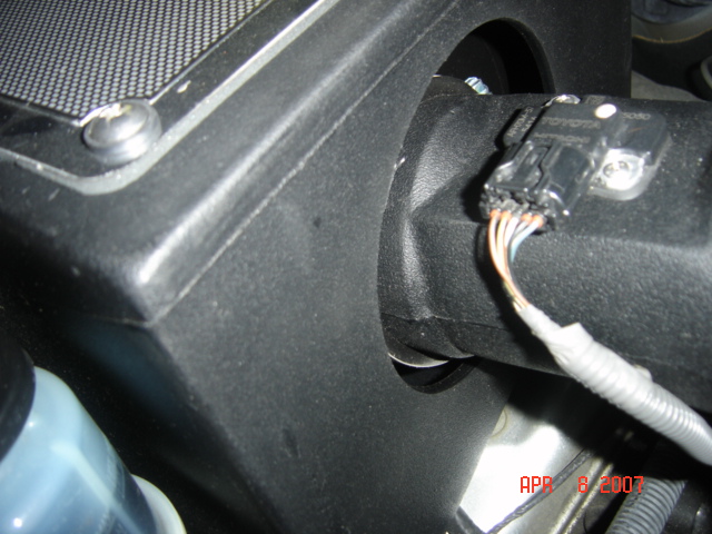

Hi all, I am having a little problem with my volant CAI. The rubber tubing that goes around the main tube into the box itself keeps sliping off. Everytime I put it back in upon a little hard accekation the rubber tube comes off . Is there any suggestion(s) from anyone who has the volant on a 05-06 v8 4runner? Sorry about the pic. I only have one that size will fit on this forum, but the rubber tubing that goes around the opening of the main tube with the maf sensor entering the airbox. It won't stay on and keeps moving and sliping off.

Mine was tough to install because I did it around the tube while it was already inside the airbox. If that is what you are doing, maybe remove the tube and install it and make sure the flexible edges are tight against the box. If that doesn't work, glue it on there!!
If you are going to use a glue and planning to use your 4R within an hour or so use a O2 sensor safe glue w/c you can buy at the auto store. Or use a regular glue but dont use or even start your 4R for more than 24 hours. Otherwise your CEL will be always on.

About the seal...you really have to push it in there and make sure it seats all the way to the edge. if it isn't, it eventually works it way out. took me a bit.
