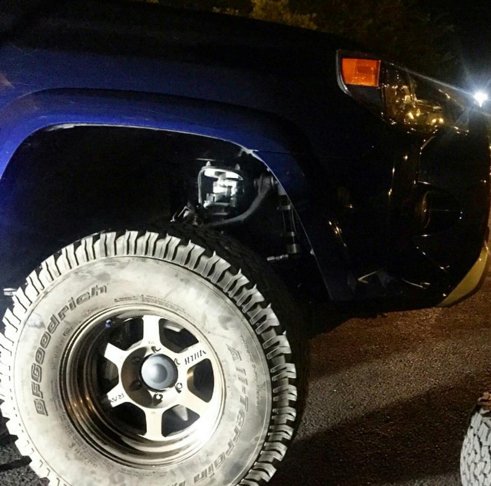

Did a lot of research on this and found a guy who tried to fit 16x8 -20 mm te37x. It rubbed on the brake caliper and dust shield. Too much of a hassle for me.

That'll be even worse if the rub is on the face of the caliper. It's the inside circumference of the wheel that's causing it to rub. That why 17s are needed unless you basically go -1000 mm offset so that it's pushed out so far it won't touch anything.
You can shave the caliper and dust shield as needed or just replace the rotor and caliper with the ones off of a FJ(and also modify the dust shield slightly).

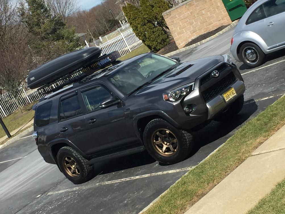

That's what I'm running with 285/65/18
18x9 0 offset
