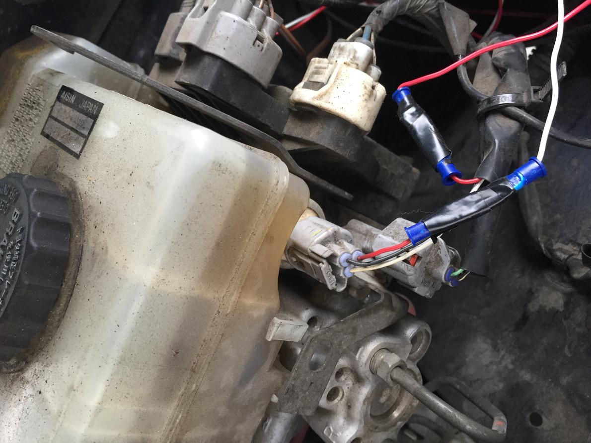

So, I recently completed the VSC off mod works great btw, I spliced into the RED wire on the master cylinder for traction control.
HOWEVER
Yesterday I was bleeding my rear brakes, and noticed my right rear caliper was dead when I had my buddy stepping on the brake pedal. Thinking it could have something to do with the mod, We turned the car on and engaged the switched so all circuits were in tact and not interrupted. Sure enough the caliper came back to life.
This is concerning to me since at least one caliper is dead with the VSC circuit interrupted. I did not have a chance to check if the the fronts are affected by it yet.
Anyone have any insight?
THANKS!!

Sounds like the Skid Control ECU decided that since you effectively skewed/altered the Pressure Sensor reading by eliminating the Ground (the Red Wire you're tapped into, I know I did a double take when I looked at it too...) it decided it shouldn't operate the valves on the solenoid pack? That or you did something wrong...
Ya I'm at a loss on this one Black Works. Everything I did is as follows with everyone's write ups and I wont have time until this next weekend to see if any of the other calipers are effected.. will be interesting to see.
