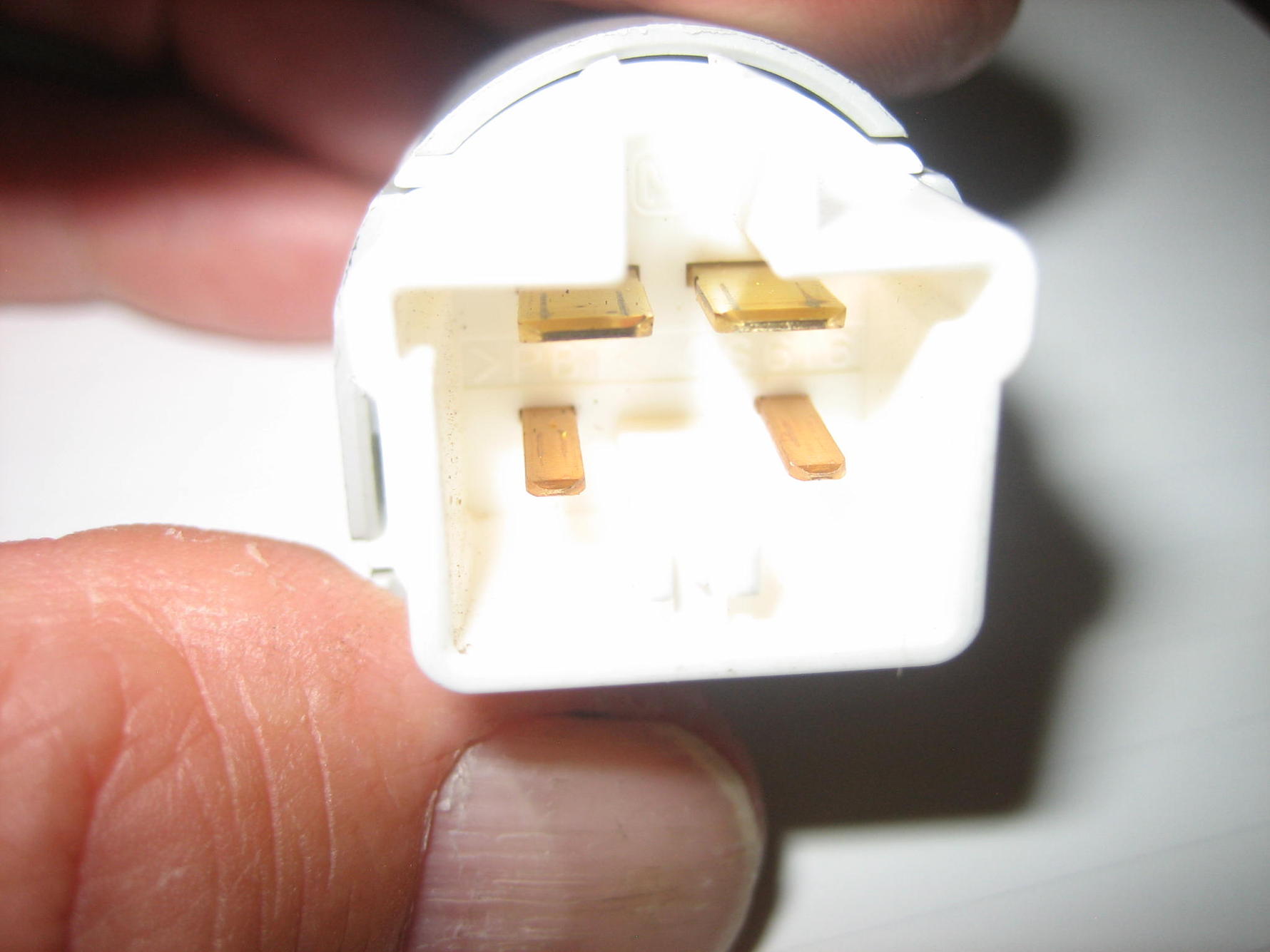

The brake light switch has 4 flat contacts. Two are connected to the brake lights & two are connected to the Skid Control ECU.
http://4runnerclub.com/i/4r_files/f...wd/07toypdf/ewdsrc/2007/4runner/h/em03m18.pdf
I tested the switch & it had intermittent continuity between the two smaller contacts. I replaced the switch & all is OK for the past few weeks...including a 38 mile drive on a mildly rough dirt road here in the Colorado mountains.

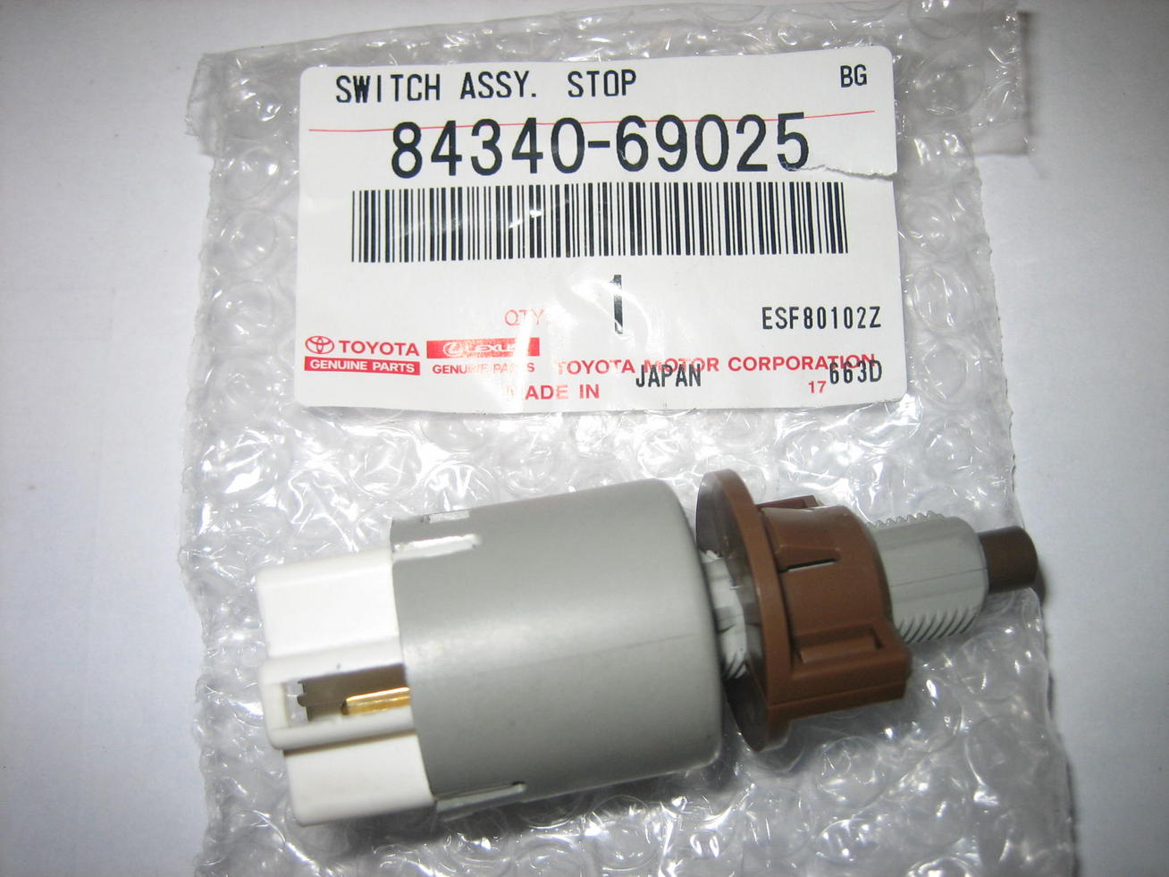

Here is another pic of the switch. $27.00
I disassembled the switch. It was not apparent what failed. I believe the contacts were dirty....causing intermittent continuity.
