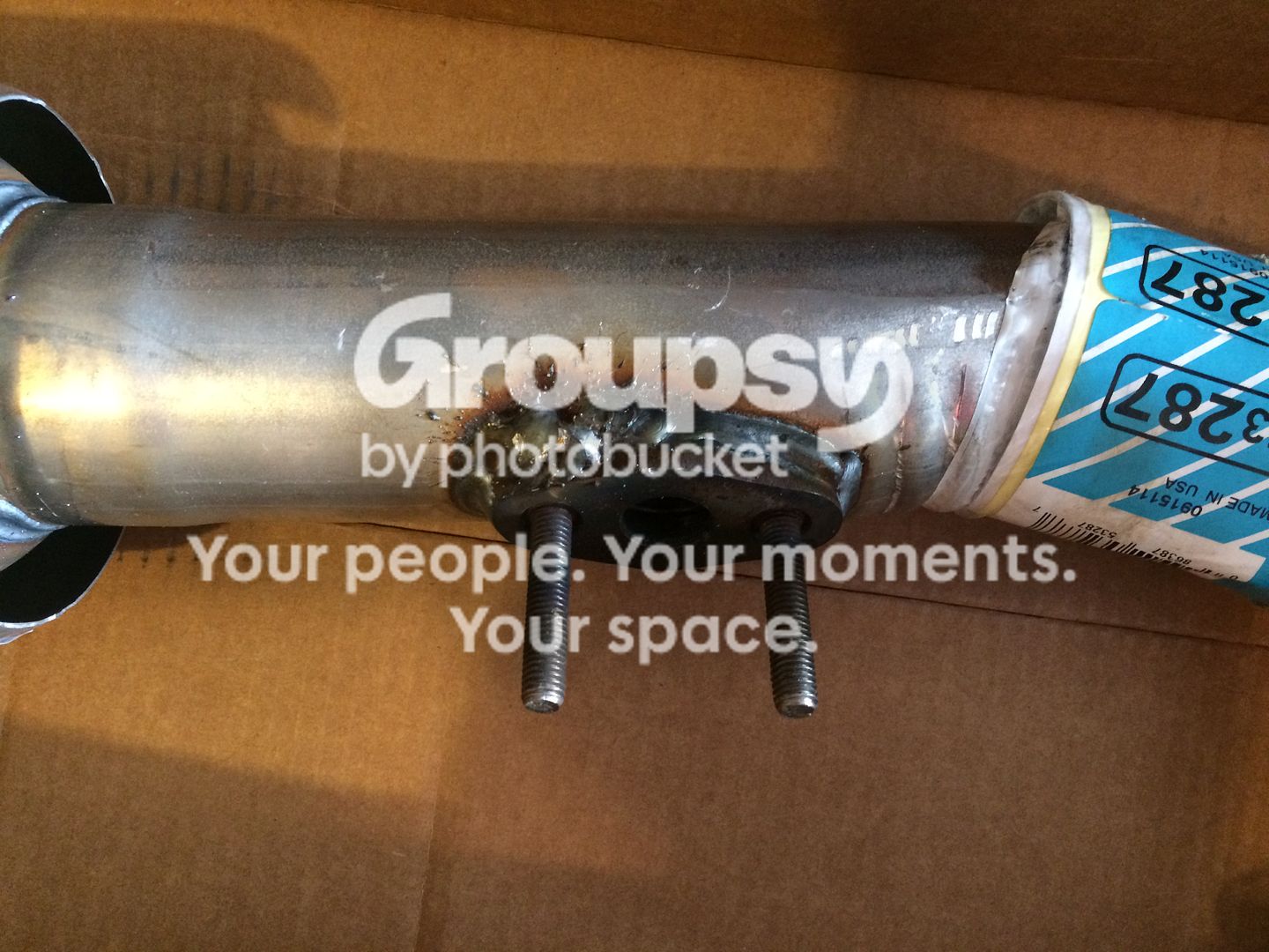

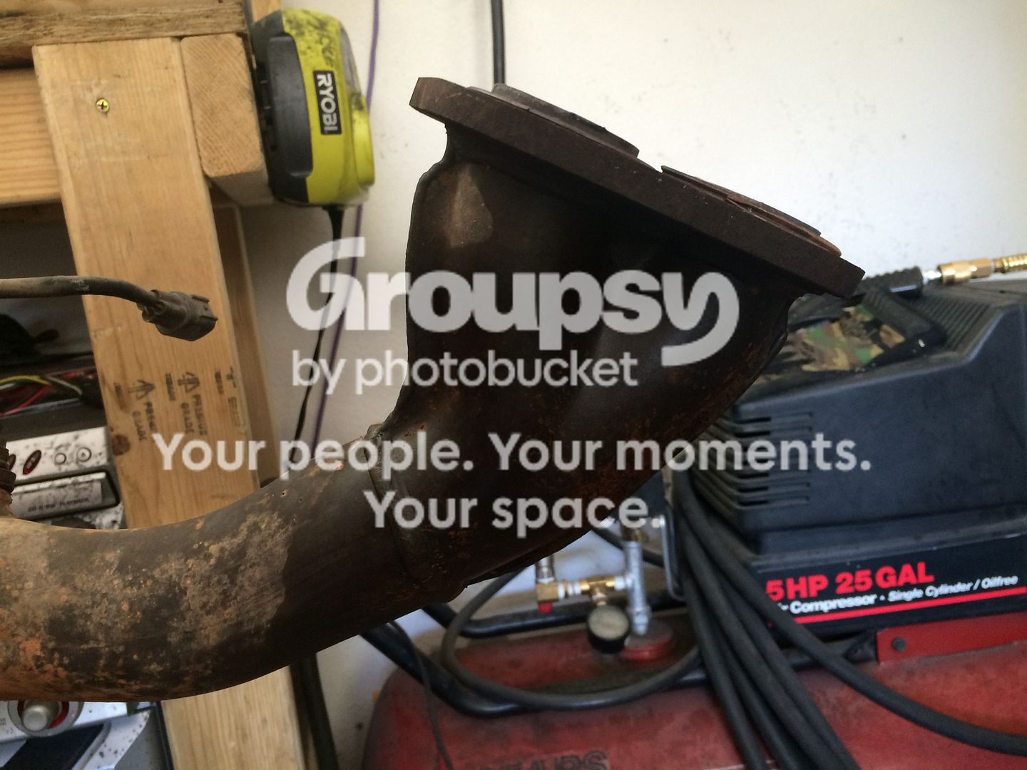

Coming out of the box, the first thing I noticed was that some of the welds were ridiculous! since pictures are worth 1000 words....
Not even sure what happened here:
That one didn't bother me to much, but the next one I'll show you did... This is the area I'm talking about....

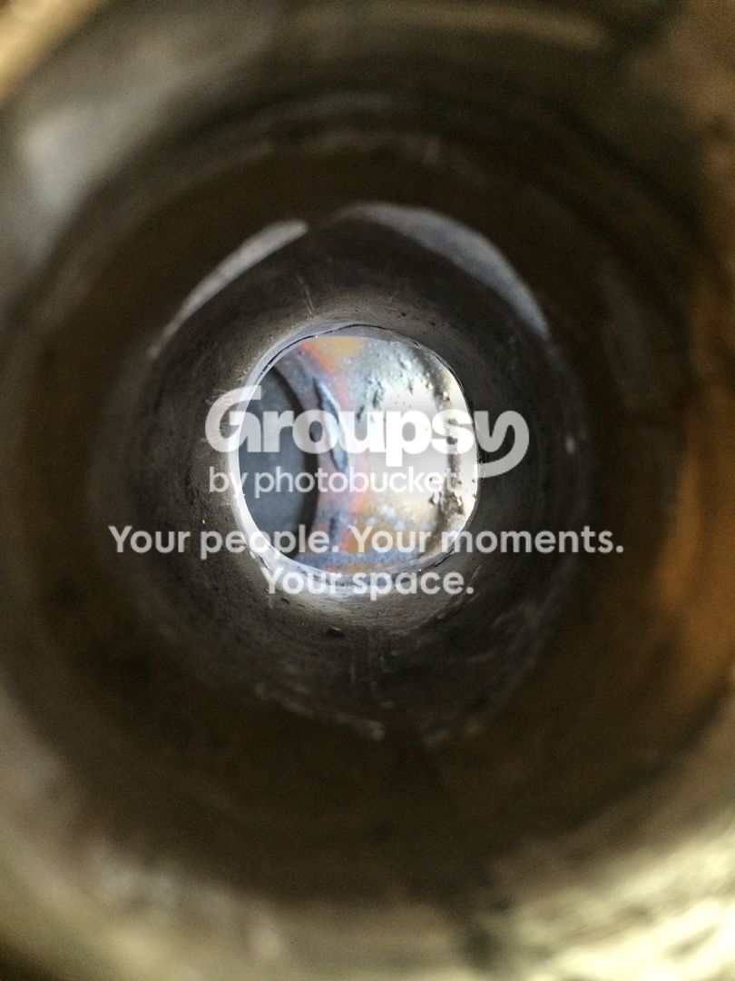

And this is inside the rear most pipe, sorry I thought I had the correct area in focus, but you get the idea.
The weld blew through where (I'm assuming) the gap wasn't good or the heat was to high or something.
I thought about sending it back, but figured I'd probably just get another one like it. So I decided to just fix it myself. I took a "long necked" die grinder with a grinding stone and smoothed it down. Being careful to keep crap out of the CAT itself. I shoved a rag down the o2 sensor hole and used a vacuum. Better picture:
Now I know on a N/A, 3.4L, 4Runner, it probably wouldn't make any difference having the weld in the pipe like that. It bothered me though, and that was enough to clean it up in my book.

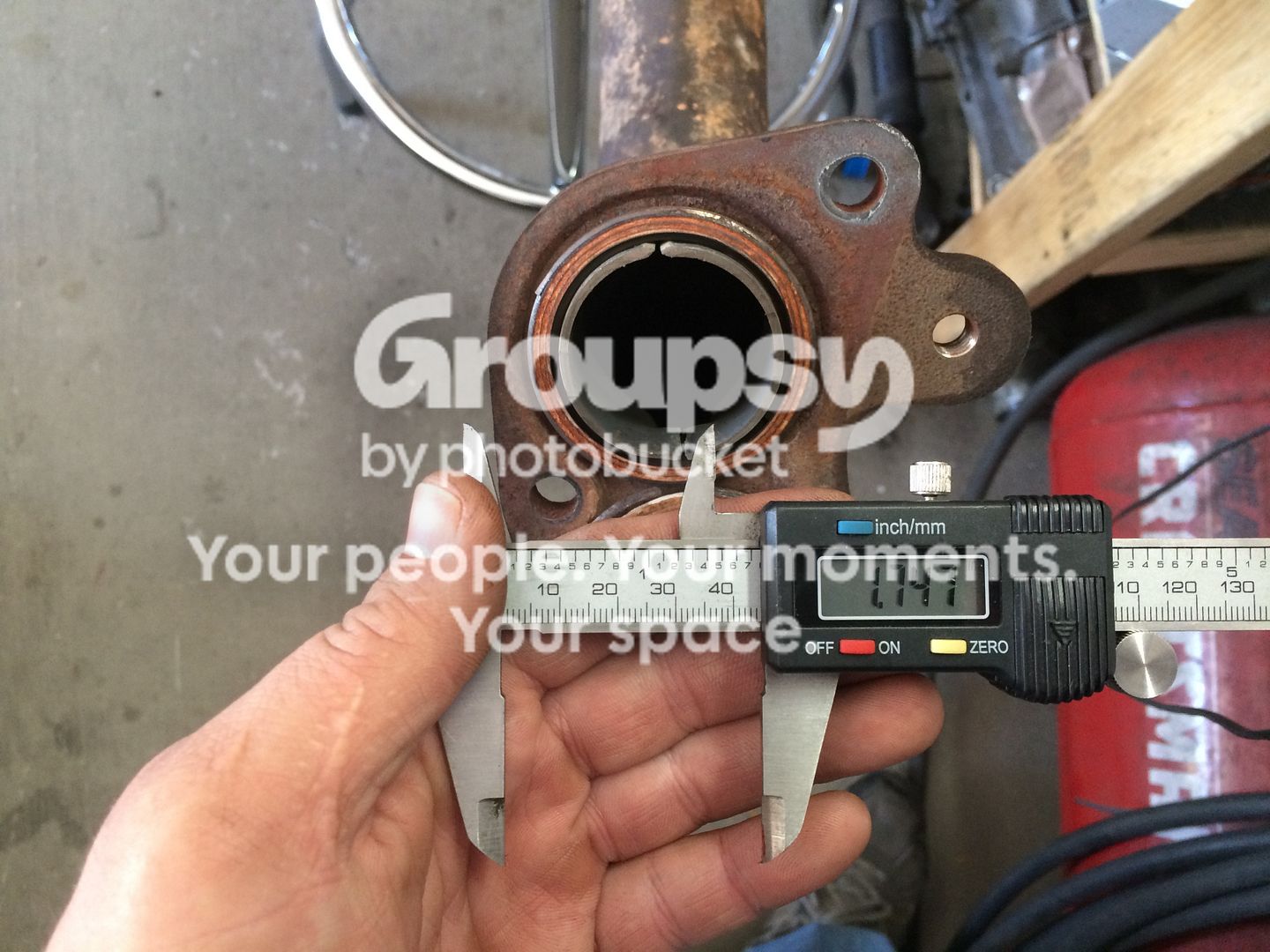

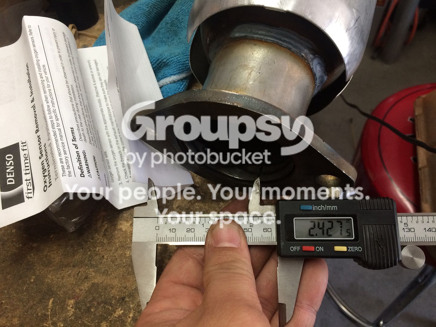

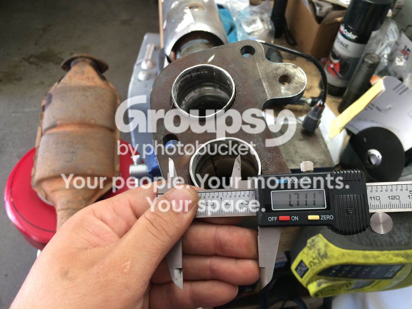

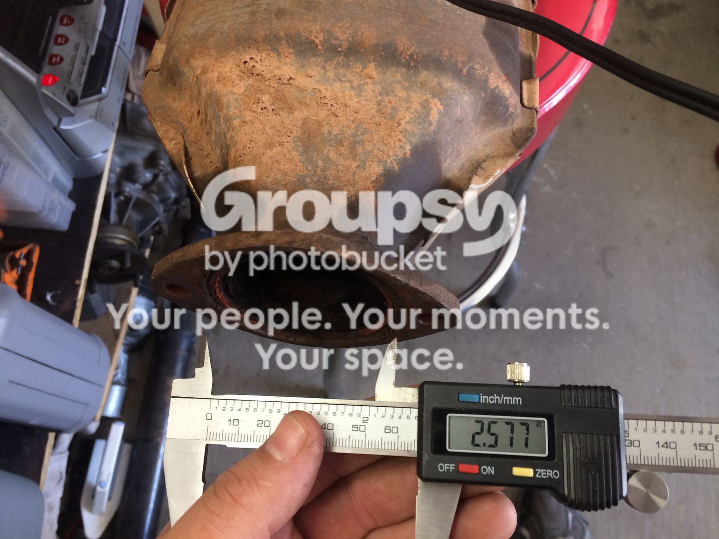

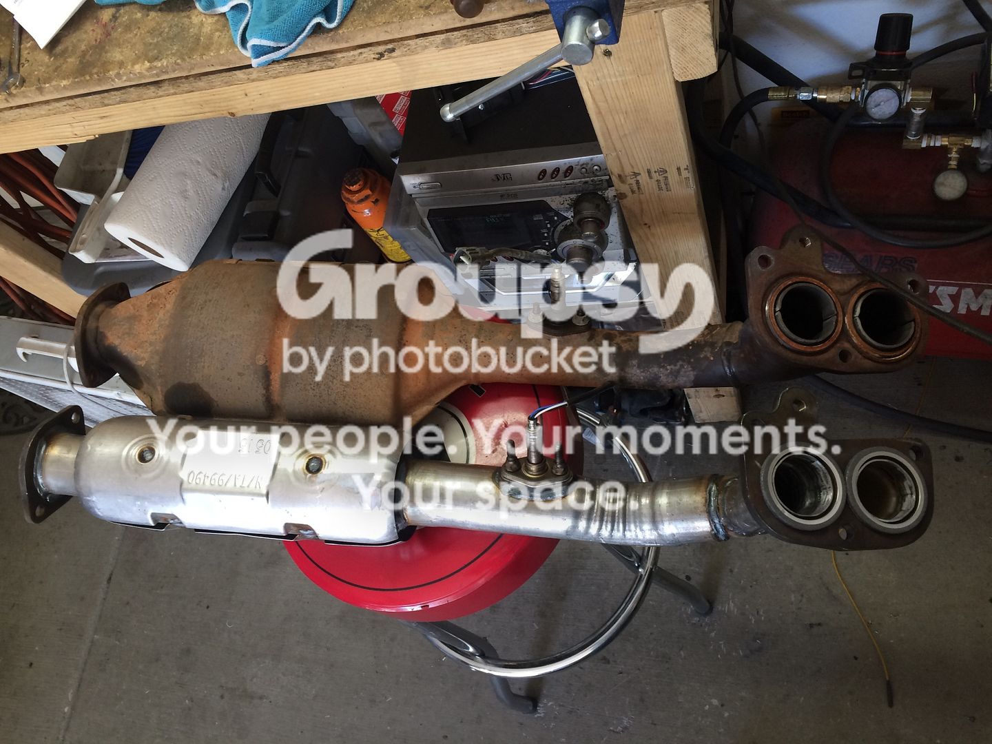

For other references, here is all the pipe sizes and such, compared to the OEM unit. OEM on top pic, Walker on bottom:
Inlet pipe size:
Rear output pipe size:

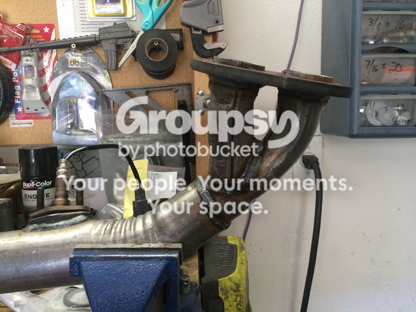

Couple side by side comparisons:
As far as mounting it in the truck, it bolted right in with 0 issues. In fact it was easier to get in the truck just because the CAT is physically smaller. I've put 100 miles on the truck with a no check engine light. I haven't had enough time on it yet to see if my mileage is any better, but even if it did, would probably have more to do with the 2 new o2 sensors than the cat. Sure it can't hurt though. I did keep my old CAT in case I want to change it back or put a high flow cat on it or something.

You should of just try new sensors. I bought a walker for my town car, but it was 100 better than the one you took pics.
Made in America my friend, written all over it. Along with the gaskets from Walker I used when I put it in. See the very first pic, blue tag.
I could have probably got by with just new sensors, but with almost 200K miles, I figured what the heck. Again, I still have the old one and I'm going to hold onto it.
That's what I was thinking until I saw "Made in USA" on the label.
Would have sent that back.
Damn....you're right. Obviously it's a race for the bottom when it comes to quality. Looks like Walker may be well into the lead on this one! :car::horn:
The bends and weld quality of the newer 01-02 Walker cats were like yours,definitely not as clean as OEM. I was a also a little concerned about the smaller tube diameters but left them as-is, just looked it over for loose welding slag and went over all threads with a tap and die (had to tap the O2 sensor bungs on my Tundra's JBA headers due welding slag).
I've put several thousand miles since installing them and the smaller exhaust tubing has not negatively impacted driveability or mileage. At the time I bought them there was a 30 or 35% discount code at Pep Boys plus a $100 manufacturer rebate,suffice to say I saved a crapload of money over OEM and don't regret my decision.
