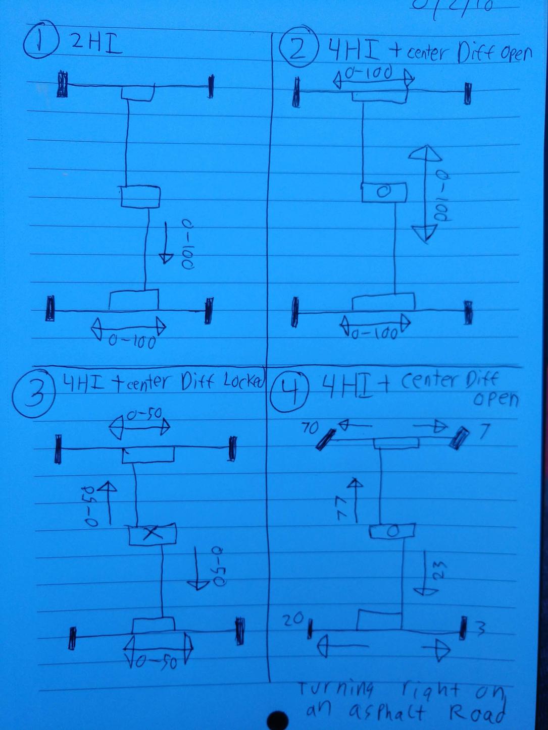

I tried to make some diagrams of it to make sure I'm getting it right and would love if you all could help me confirm my understanding of it.
The first three being diagrams to understand where it can send power. And the fourth being one showing it make an at-speed turn and the power delivery at that moment.

I think you get the principals, or are pretty close to.
But technically, in diagram 1, shouldn't it be 100% for the rear driveshaft not 0-100%. The front would see the 0%.
Diagram 3, with the center diff locked, you will always have at least 1 tire on the front axle and one tire on the back axle receiving power so I dont think the 0-50% at each end of the t-case is accurate.

Absolutely not. I have been in the 4wd truck world my whole life. AWD systems have a type of clutch in the transfer case which allows for slippage when turning sharp. Out cases in 4hi do not have that clutch and will bind up on dry pavement. Test it for yourself, it's simple. Pull into a parking lot, put it in 4hi, turn the wheels hard left or right, and GENTLY try and drive away. You will feel the whole truck sorta skip or slip and your tires will chirp due to the system binding. Not going to argue, this has been brought up many times. Your truck do what you want but you've been warned.

Im trying to gain an understanding, not argue.
The reason I was led to believe it has AWD characteristics is due to the fact that my truck has a lock/unlock function for the center differential.
And at least to my rudimentary understanding of them, if a differential is in an open position like that, and if you have 3 of them set up, as the t4r does, then it cant really bind and performs like an AWD system.

That is how the t-case in the 5th gens (non limiteds) and FJ's behave. However on the 4th gens, there is an actuator that locks and unlocks the t-case so you can de-couple the front and rear driveshafts and turn on concrete.
Case in point, the 4x4 V8 4Runners only have 4hi and 4lo drive modes, with the center diff locked or unlocked.
Since my truck is a 4x4 V8 I just switched it from 4hi to 4lo on concrete and turned sharp, no binding. Like I expected. This is great for trails where you need to turn sharp, just punch the center diff unlock button, make the turn, and re-engage it.

Yes, you’re tracking of the 4WD system in the 4th gen is exactly what I believe as well. 4Hi in the 4th gen is AWD. In the 5th Gen, the SR5 and trail it’s 4WD only. Hence what 2016 is saying... but the 5th gen is not the 4th. The 4th gen is a way better system IMO for your average person.

You're correct, for your specific 4th gen model. I drive in 4HI (center diff unlocked) monthly without issue/binding with the same system.
