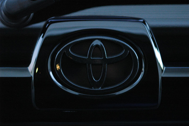

Not that the responses were overwhelming (or any at all), but I went ahead and did it myself...I also added a quick layer or two of "reflective" spray that will make the logo light up like a bike reflector at night...

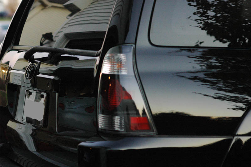

Another view...
Here's another view - here, you can also enjoy the mirror Zymol finish - you can actually see my wife's VW in a dark garage...sweet!!!

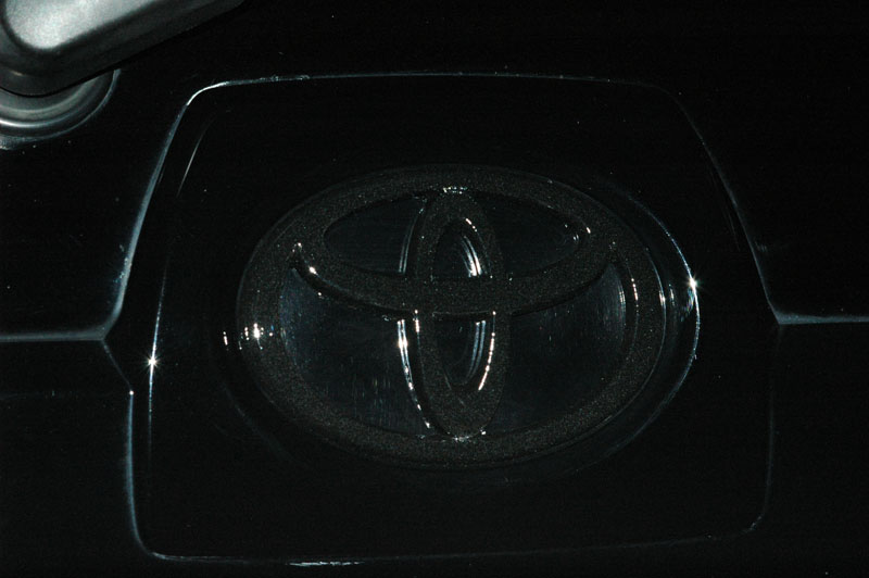

Tried it, doesn't work too well in the daylight - I figured I'd wait until it was dark out and see if I could work it out with a flashlight or something...I'll give it a shot and see!
OK here goes - not the best photographic setup, but if you look at the emblem itself you can see the little grains of reflective material glowing...also, if you compare to the first pic (above) you can see that it's "lit up" a bit...

Thanks! I suppose I am remiss in not detailing the steps I took. First, I sanded down the emblem using a 220 grit paper (to increase adhesion) - just did it by hand, nothing fancy. Then, I lay down two base coats using "Rust-O-Leum for Plastic" in a plain black color. Then, I lay two coats using (Rust-O-Leum) the "specialty reflective" clear coat, and then several (was getting late by that time...) coats of just plain clear coat (mine was Krylon, but any brand/style will do). Depending on where you're at (climate-wise), I was out in the garage (Northern Illinois) and I used a plug-in heater to speed drying, and didn't let it go more than 45 minutes or so between coats. All paints available at Home Depot. Basically, the long story short is that you can essentially paint your emblem any color you like, as long as you're careful when you spray and you allow enough time for curing (or use a heater like I did). The sky's the limit! Plus, the good news is that if you order a new emblem from PartzNet (less than 30 bucks) it comes COMPLETE with pre-placed adhesive, saving you a GINORMOUS pain in the bootie...well worth it if you ask me...

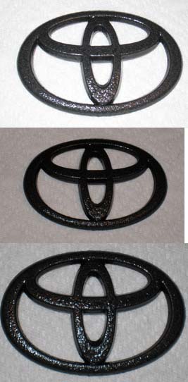

I used rustoleum paint for plastic. I chose the "hammered black" and then put a couple clear coats on. 3M mounting tape to place back on. In regards to debadging and residue...goo gone barely worked. I dont think its that great of a product. I used to use a product called "Energine". It was an industrial grade spot remover but still safe on my old car's paint. I had to heat up the residual residue (haha) and rub with a towel, my finger, etc. to get it all off. Pain in the butt though it looks great now.
