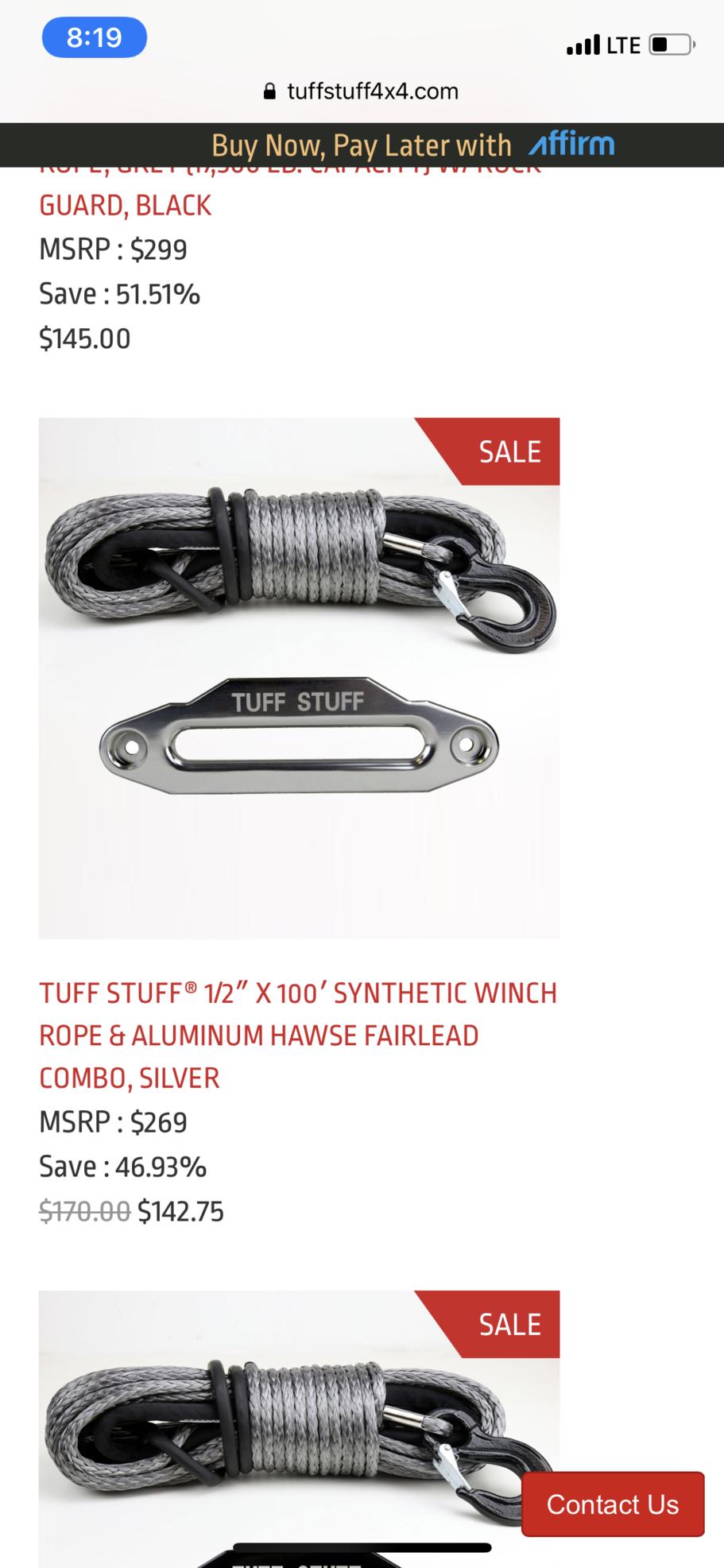

I just bought this combo for my supwewinch 9500 tiger shark.
Waiting on all the parts to install everything at once.
