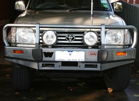

Did you have to drill that hole into the bumper? And how is it mounted inside the bumper - did you have to construct your own bracket? That's a nice streamlined solution right there!
Also, do I need to clock the winch so I will be able to lock/unlock the spool, or is the default orientation going to be okay? I watched a YouTube video and apparently all you have to do is loosen the housing bolts and twist?
That bumper is the ARB 90 series Prado bumper, not the Tacoma one. It comes with the W cutout and other associated holes from the factory. This was the only bullbar that ARB did this on and it was not popular because if you did not have a winch, the empty W looked silly, and it only worked for Warn so that limited your winch options.
