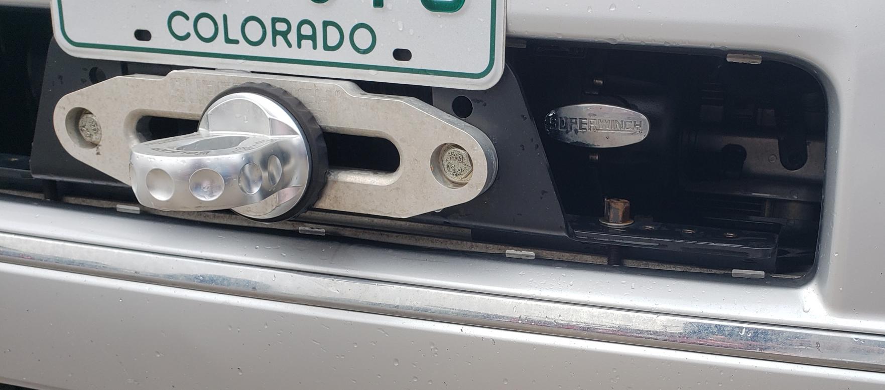

Mine is a Superwinch but I think you could do the same thing with a Warn: I just clocked it 90deg so I can just reach in from the front.
