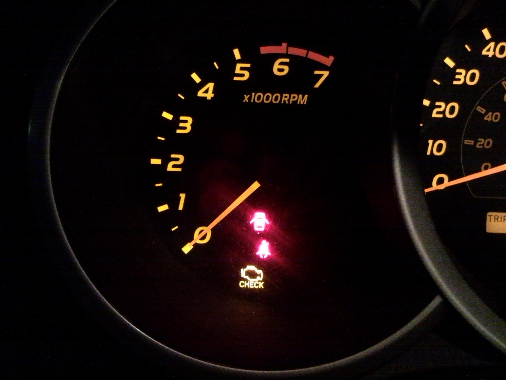

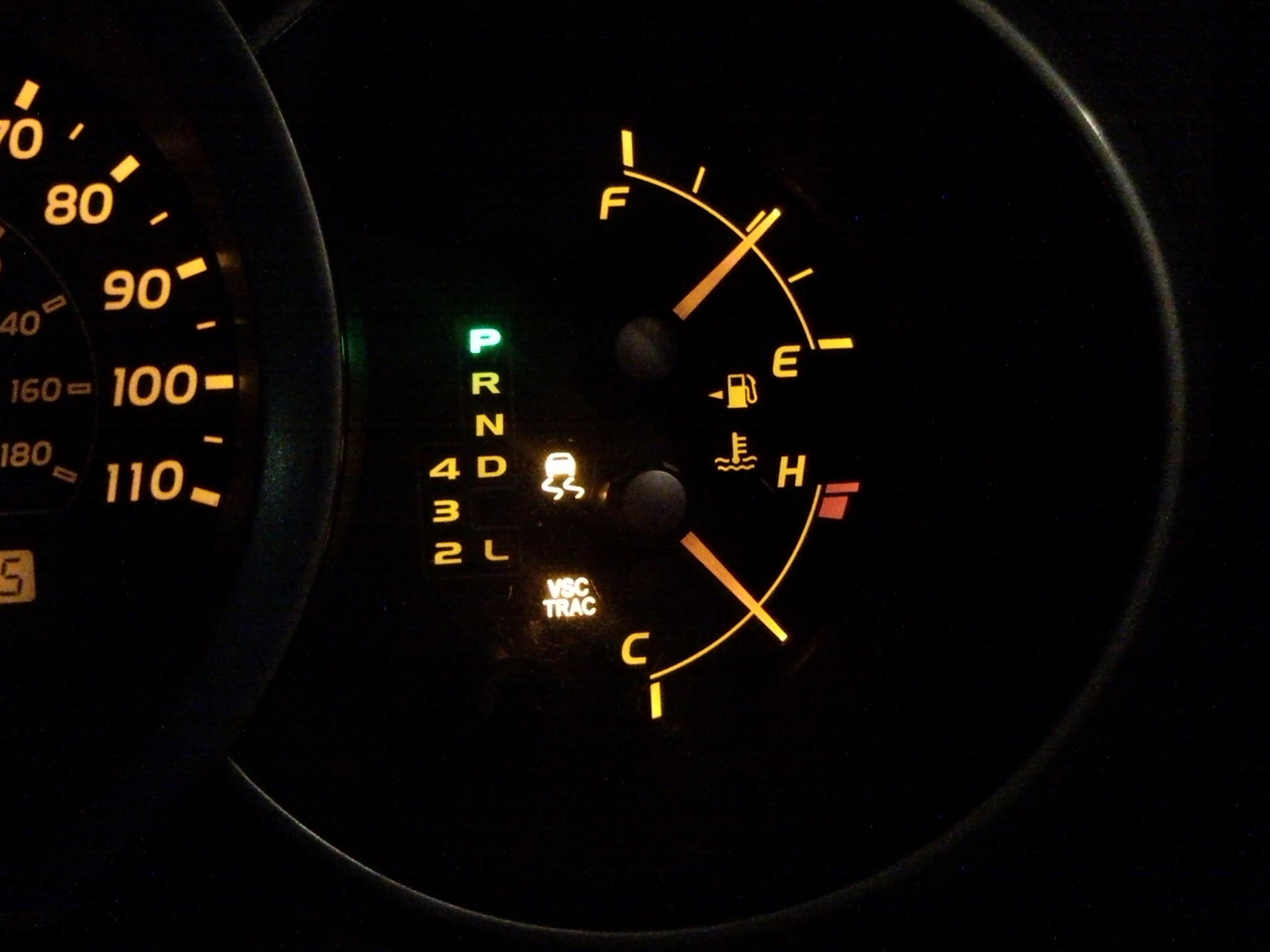

Anyway, here about two weeks ago, our 06 SR5 4.0L came up with some warning lights. The Check Engine light, the VSC light, and the Traction Control light are all lit up on my guage cluster. I assume I knew what it was, and I was aware that the front brake pads were getting pretty thin and ready to go. So, I checked them and sure enough, they were shot, and the brake fluid was very low from the pistons being so extended. This was what I though was the reason for all the lights, the low fluid. So, I had the front rotors surfaced, put on some Wagner Thermo-Quiet pads, and pressure washed the whole suspension up while I had the wheels off the car. I took it out and bedded in the brakes and drove it a while, and all the lights stayed on. Hmm. I disconnected the neg side of the battery for about 10 minutes and wiped out the PCM's memory. Reconnected the battery, voila, lights went of and stayed off, brakes worked great, figured I had the problem licked.
Week went by with no problems, and today, the Check Engine light, the VSC, and the Traction Control light all came back on again. Damn.
Any ideas what this could be? I have 7 year 100K warranty so Im going to take it in but I'd like to have an idea of what it is before I take it in, so they dont try to BS me.
I have what sounds like it might be a similar problem on an 09 SR5 4WD. I don't have the Check Engine light though. Below are the lights that I get. It is intermittent, but getting a bit more frequent, so I need to locate the problem. I am off factory warranty and have no extended, so hope to find the problem myself to save some $.
Awhile back, I started a thread asking for advice, got one response, but it was pretty general, so I haven't tackled it yet. That short thread is here:
http://www.toyota-4runner.org/4th-g...hing-dash-warning-lights-how-investigate.html
These are the lights I'm getting, one above the other in the dash, top to bottom:
VSC OFF -- It flashes
The pic of a car skidding in a square -- It is a solid light
ABS -- It is a solid light
Are these the same as yours, other than you also get the Check Engine light?
Can anyone advice both the OP and myself as to how to find the problems causing our dash lights to light up, and fix it?

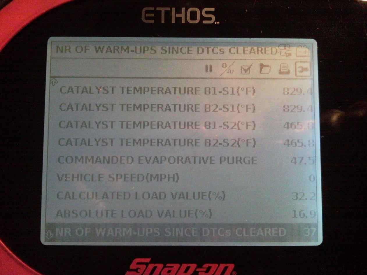

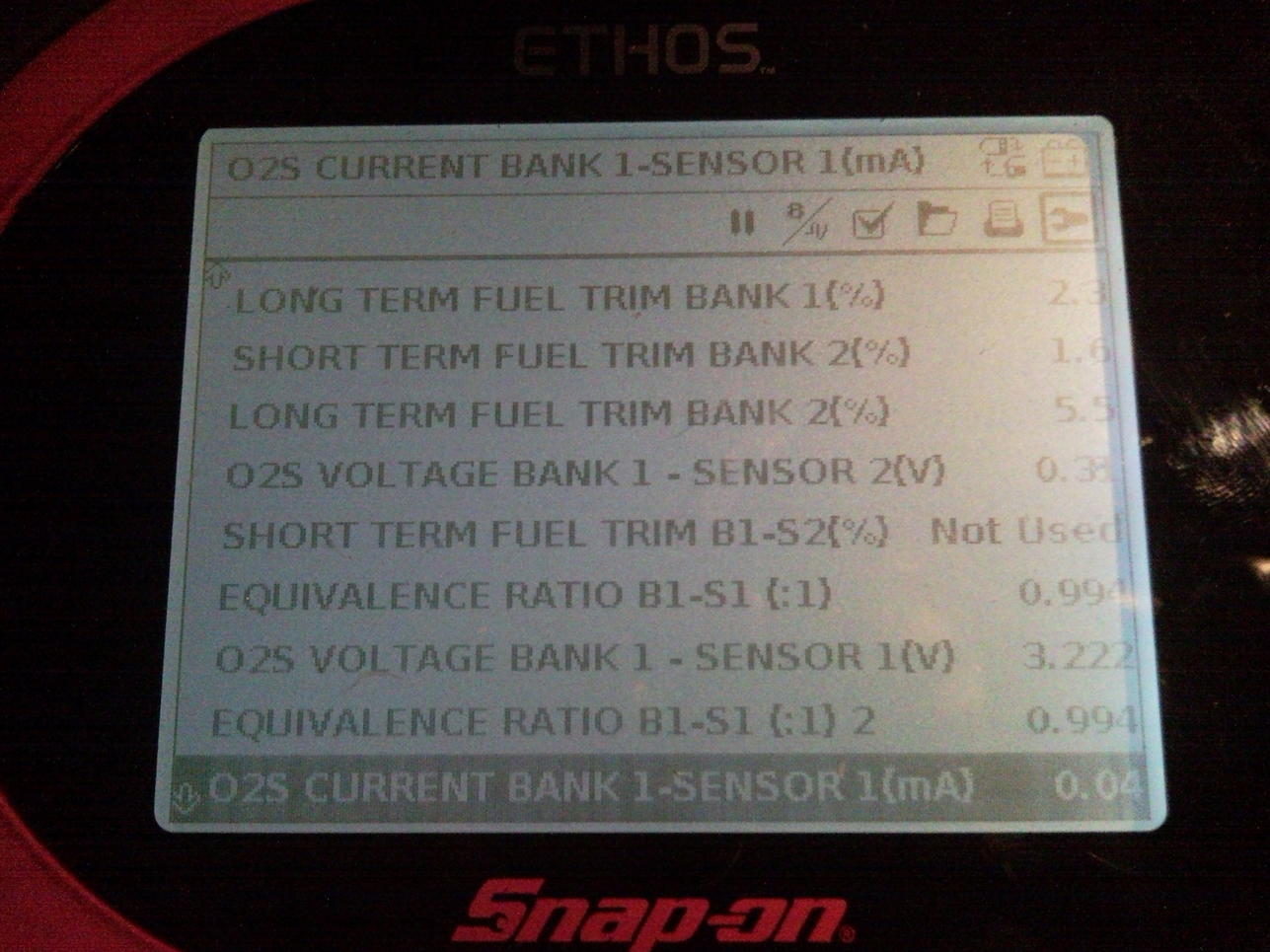

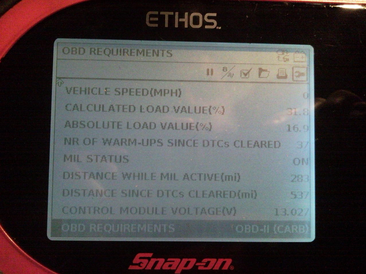

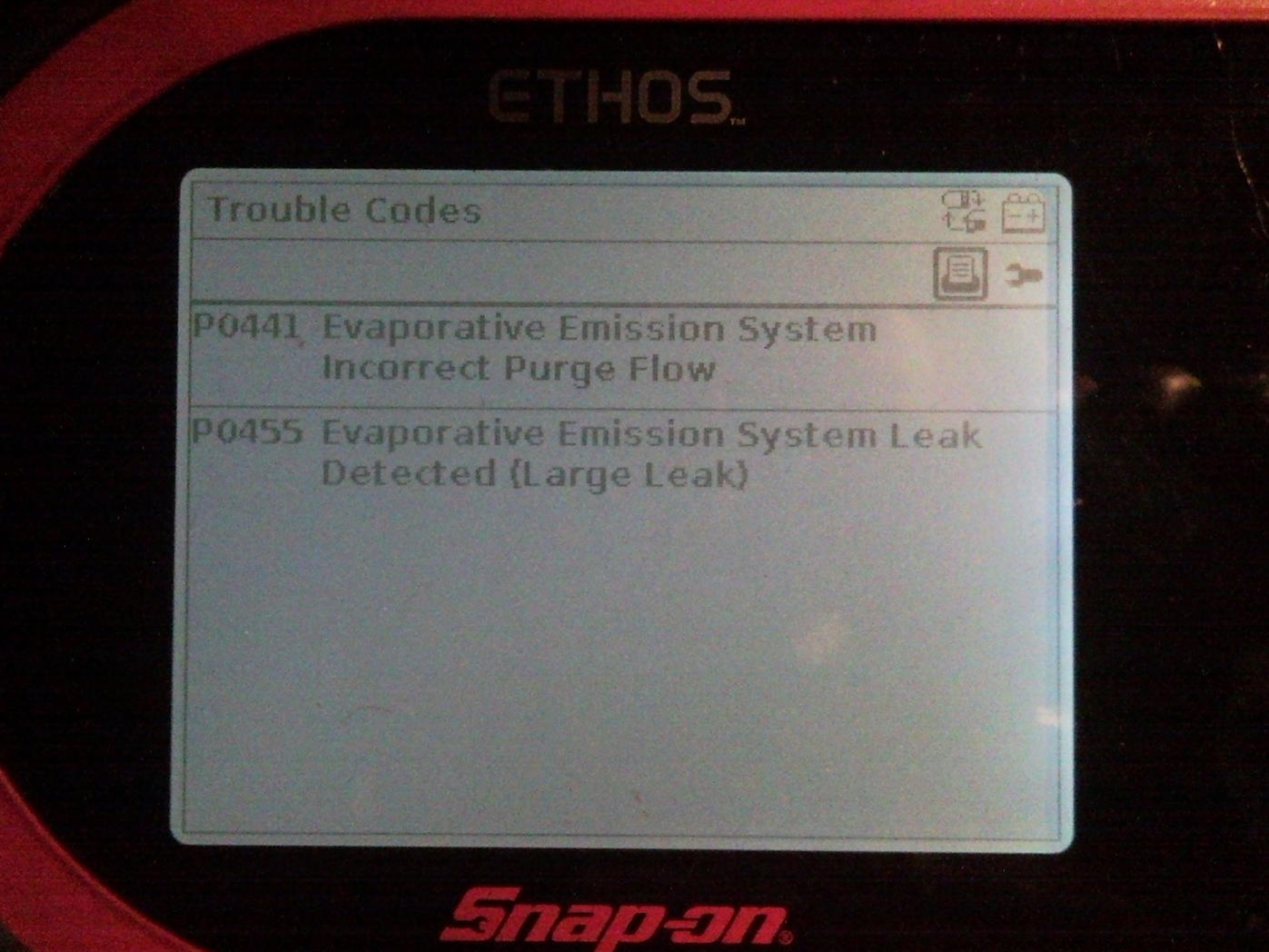

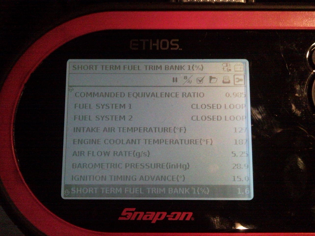

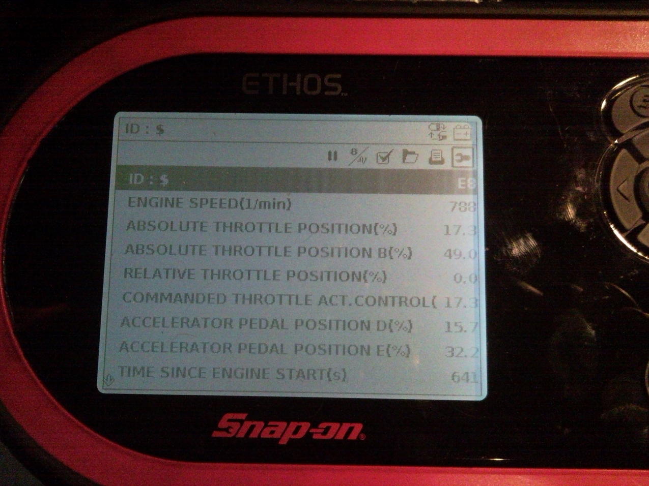

Here's my codes from my borrowed Ethos. Looks like a large Evap leak somewhere. I'll get a new gas cap but I doubt that's it. It passed inspection just a couple months ago, but I know, **** happens right? lol.
Anything you guys can make of the readings? I dont know enough about what the values are "supposed" to be to know if anything's wrong?

Note the codes down, reset them and make sure the gas cap is on tight. You'll need to drive it for a while or use the scantool to manually run the emissions monitors.
Its mostly the codes that get set for Gas Cap being loose. If after you tighten the gas cap and run the monitors you're still getting a gross leak code, have the cap pressure tested at a smog shop to verify the issue. That's where I would start, as for the data? It looks nominal and makes me think the cap is loose or failing.

Well, feeling a little red but it was the simplest answer. Gas Cap. Dropped my runner off today for warranty work to fix the Ck Eng light problem and they called back and said it was a faulty gas cap. Said it tightened fine (like I already knew, it clicked like normal...) but when they tested it for pressure it held none. I told him to whack me with a pvc pipe for not replacing that earlier lol.
