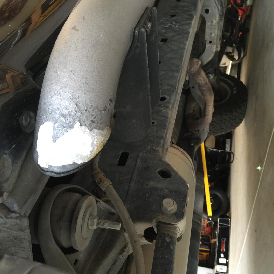

Sorry for the long post but wanted to warn everyone who owns/looking to buy the Sport Edition nerf bars about a lesson I had to learn the hard way. Maybe some of the owners already know this, but definitely wanted to let people looking to purchase a set know. Hopefully prevent you from damaging your nerf bars, or purchasing some bad bars.
Make sure the end caps on your nerf bars are completely sealed. If not, you're going to have some major problems. Why?
I bought some second hand nerf bars from a member I won't name. He'd sent me picture of them and they looked pretty good (especially for $100). Long story short (not really), he shipped them to me and when I opened them they were pretty dirty. Went to go wash them in the yard (hand wash and didn't really noticed anything wrong yet). Toweled them off and noticed some chipped paint on the ends (only noticed one spot, in the same spot on both bars). Wasn't happy but wasn't a deal breaker at this point. Started putting them on my SR5 and noticed a few more chipped spots under the one I was putting on. (Oh well.. They're on the bottom. No one will be able to see them) Go to put on the second one and notice more chipped spots under it also. Threw the bolts on the second bar real quick and then started to take a closer look at the bars. What I found is that all 4 end caps were not sealed completely on the bars. Some form of water (rain/snow/who knows) had been getting through the unsealed end caps and sitting in the bottom of the bars on top of this layer that is chipping off. This is why the chipped paint was more profound on the ends. It's rotted a lot of the bars paint layer and will probably be popping off here shortly also. Here's the bigger problems, the material up under this chipped layer doesn't seam to be metal. It feels more like a styrofoam. Not 100% on this, but don't think you can paint that stuff and have it look factory quality again (I'm sure there's that 1% out there that can).

If I were you, I'd clean them best as I can inside and out. Let me dry, and sand blast em. Get rid of all the old crappy top layer and bondo parts if needed. Then I would give them a good coating of rust oleum primer and line X them. Berliner or something really rugged and strong.. Also fresh. $100 is a score but you could refurbish them to factory standards if not better. I would t give up on these bars just yet, but I can come to terms with how he finessed you
Think that'll look good with the outer layer missing in areas? Seams to be a fiberglass/styrofoam underneath. May have to put something in those areas to make it flush with the rest
I have used Flex-Seal (the 'as seen on TV' stuff that seals leaks/etc) I've used on metal tools, etc and it's TOUGH and gives a powder coat texture. Black is semi-gloss finish and highly recommended. I just don't know how it holds up to sunlight..
Flex seal sounds interesting. I would say clean it well, removing all the rust. A Dremel may come in handy depending on how bad it is. Then, as mentioned, get out your bond fiberglass kit. It's not hard if you've never done fiberglass. Nerf bars are a great part to learn on anyway as they won't be noticed as much as say a door. After layers of fiberglass (depending on the strength you desire) and sanding you can use body filler to fill in any imperfections , followed by sanding again. Bedliner on top however you like it. Now you have a solid set of nerf bars for under under $50 in repairs.
