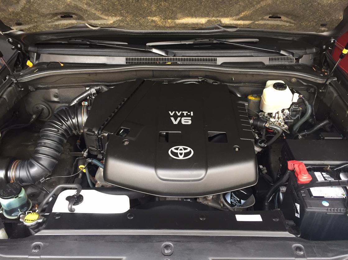

It also makes it easy to spot leaks of any kind. A little spray with Griots engine dressing afterwards.

sorry guys forgot to take before photo, here is complete. used simple green and mean green (no good reason behind that), and sprayed it down really well at the car wash. once it dried, dressed it with stoner trim shine... about as clean as a engine should be id imagine.

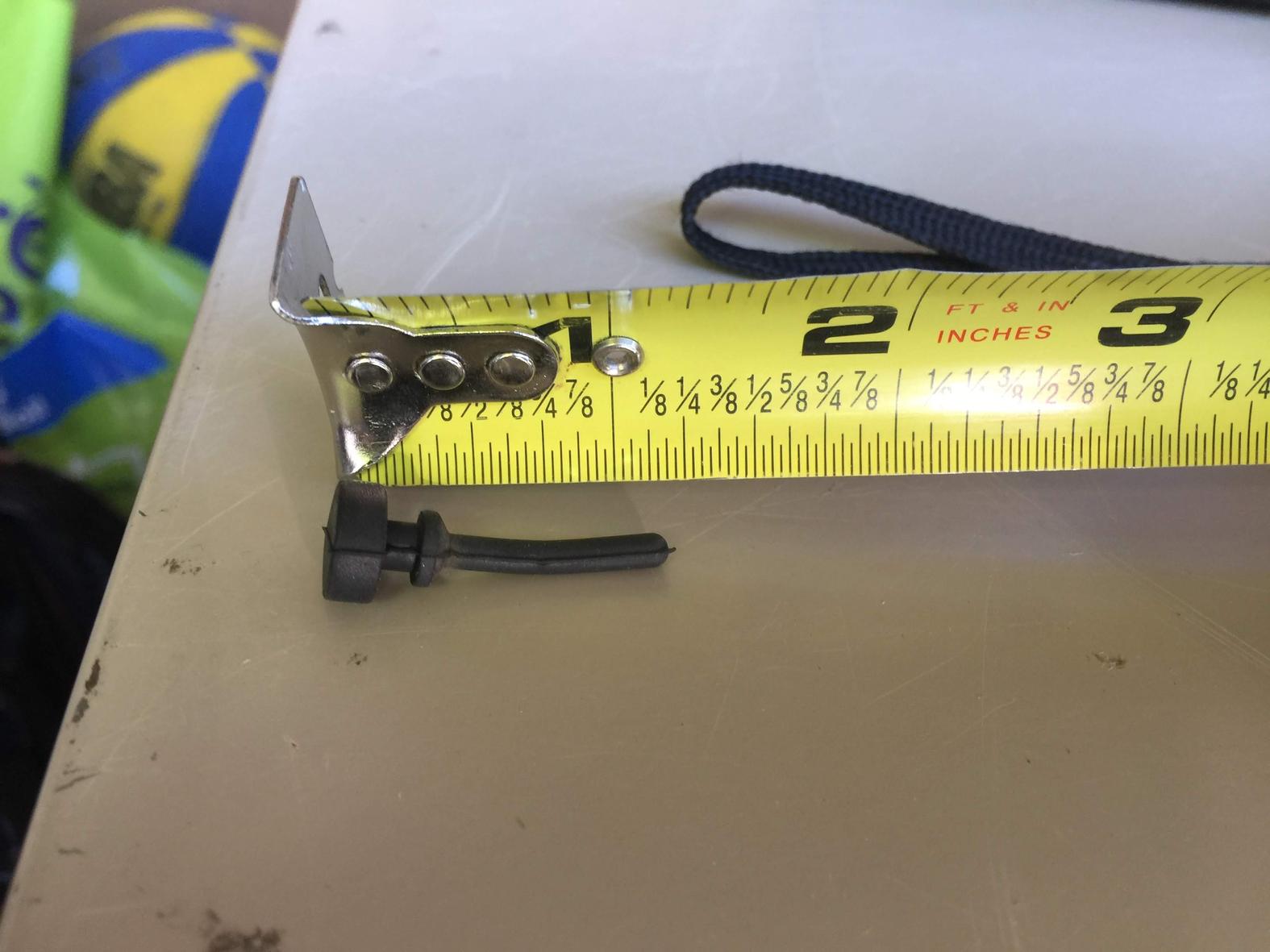

Found this rubber plug after washing engine bay. Anyone can help identify part/where it belongs? :)
It goes to the bottom of the hood under the grill. There are like 4 of them. It just pops in the hole. Mine come out when I'm wiping stuff off after washing.
