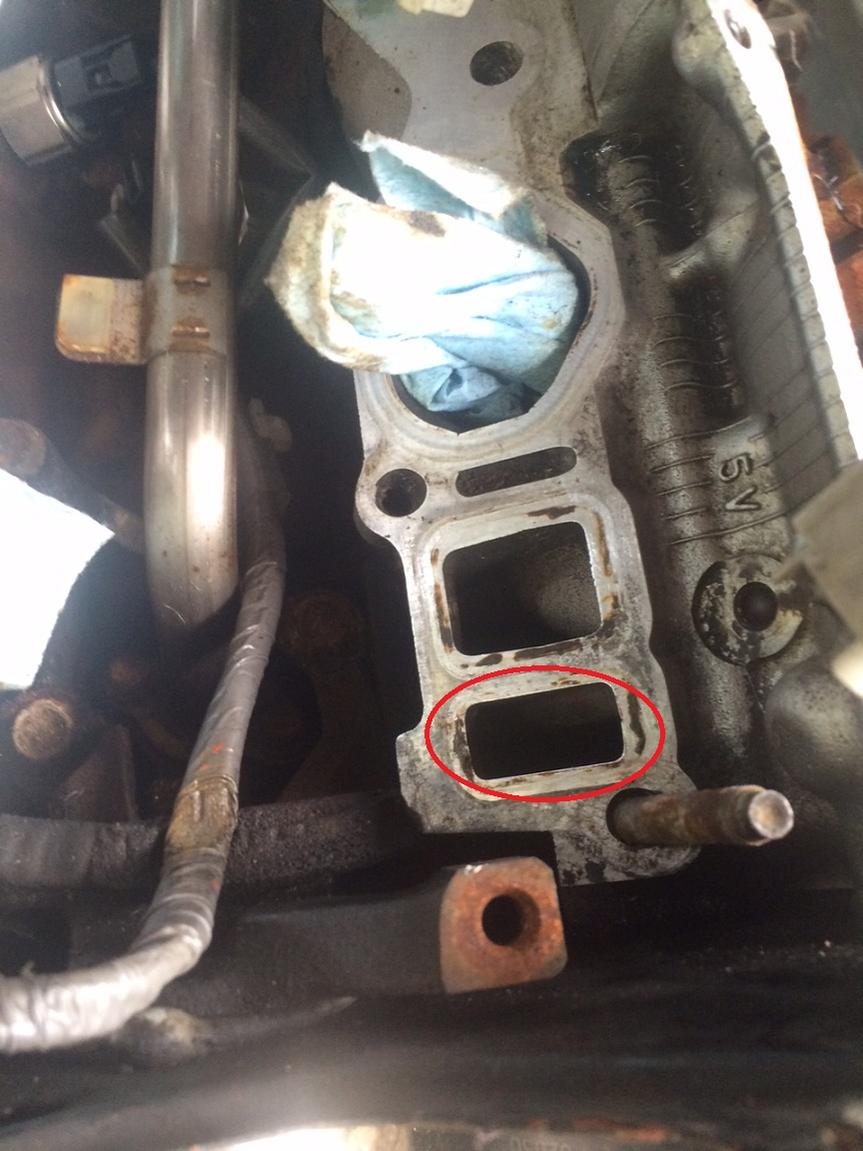

I found a washer in the coolant channel of the driver side head. When I tried to remove it with a hook tool it fell off and dropped deeper :faint:. How serious of a problem am I looking at? Think it could of made it to the thermostat? I need to do a wp/tb change so I'd much rather get it there than have to pull the head.

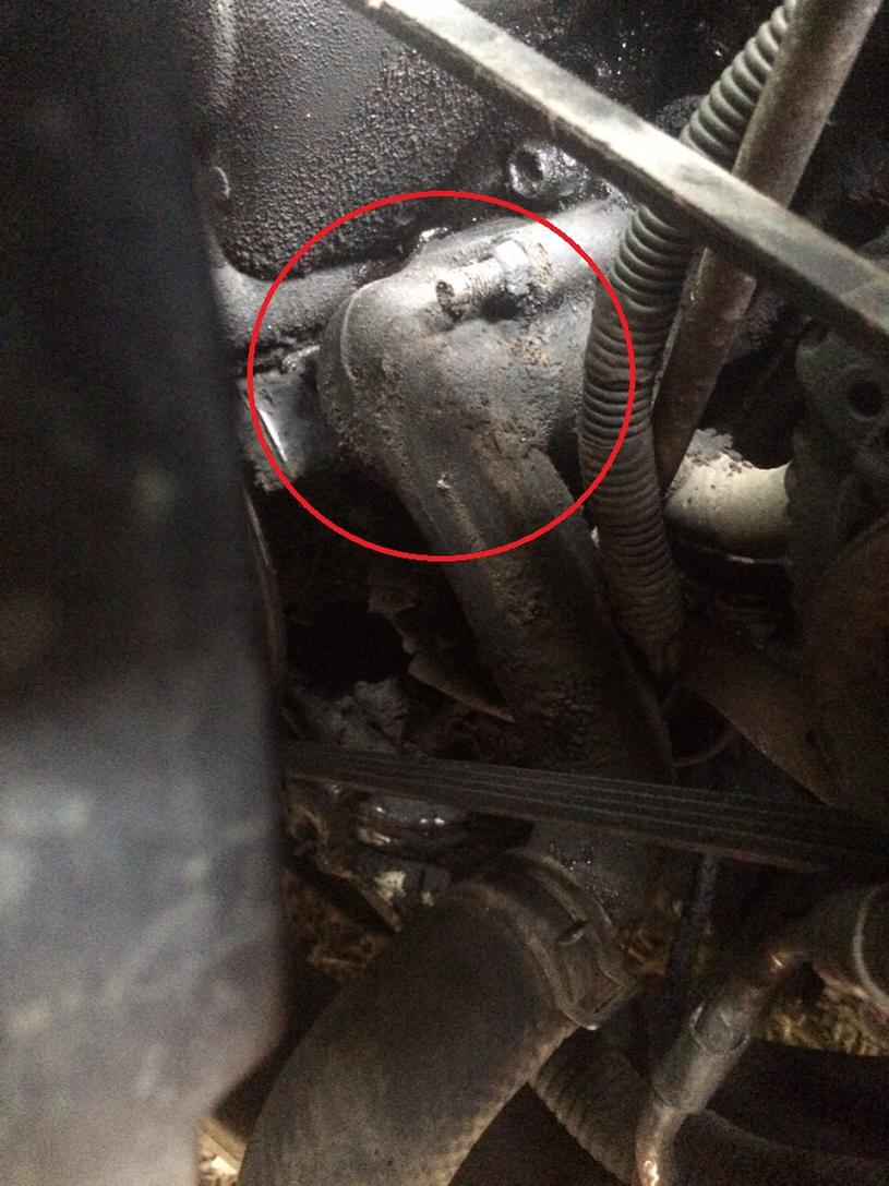

Initially I was looking at a diagram of the coolant paths that made the thermostat look a lot closer to the spot in the picture above, I really doubt it made if there unless it's a straight drop. Closer inspection makes me believe it might be in this area in the new picture. Anyone know if the channel in the above picture goes directly to the lower radiator hose?
EDIT: The 3d image of the engine I had in my head was a little off, I didn't realize this was the thermostat housing until I pulled it off, so this post was a little ill informed. Didn't find it there, I'll be picking up some magnets tomorrow to try and get it.
