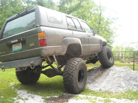

from what i have read if you move the rear shocks to the top of the rear axle you can get better flex out of it, considering ill be buying some heavy duty bilsteins i would like to do this mod.
Mine are mounted to the vertical front and rear of the axle housing and in the stock positions on the frame.
I guess the simple answer is is "It depends on your shocks and your lift." You cant flex your rig past the limitations of you shocks. Your toy needs to stop flexing before your shocks bottom out or shock damage can occur.
So I guess you need to get your shocks, measure them, then flex your truck both directions and get a measurement, then you have a basis as to where to properly attach your shocks.
Your bump stops should stop it about half an inch before they bottom and your spring should stop it before it tops out.
You have an IFS rig there anyway, I wouldn't worry about flex (cos your limited by the physics of your truck) and throw some lockers in your difs, as long as you have traction who cares if your lifting tires in the air?
