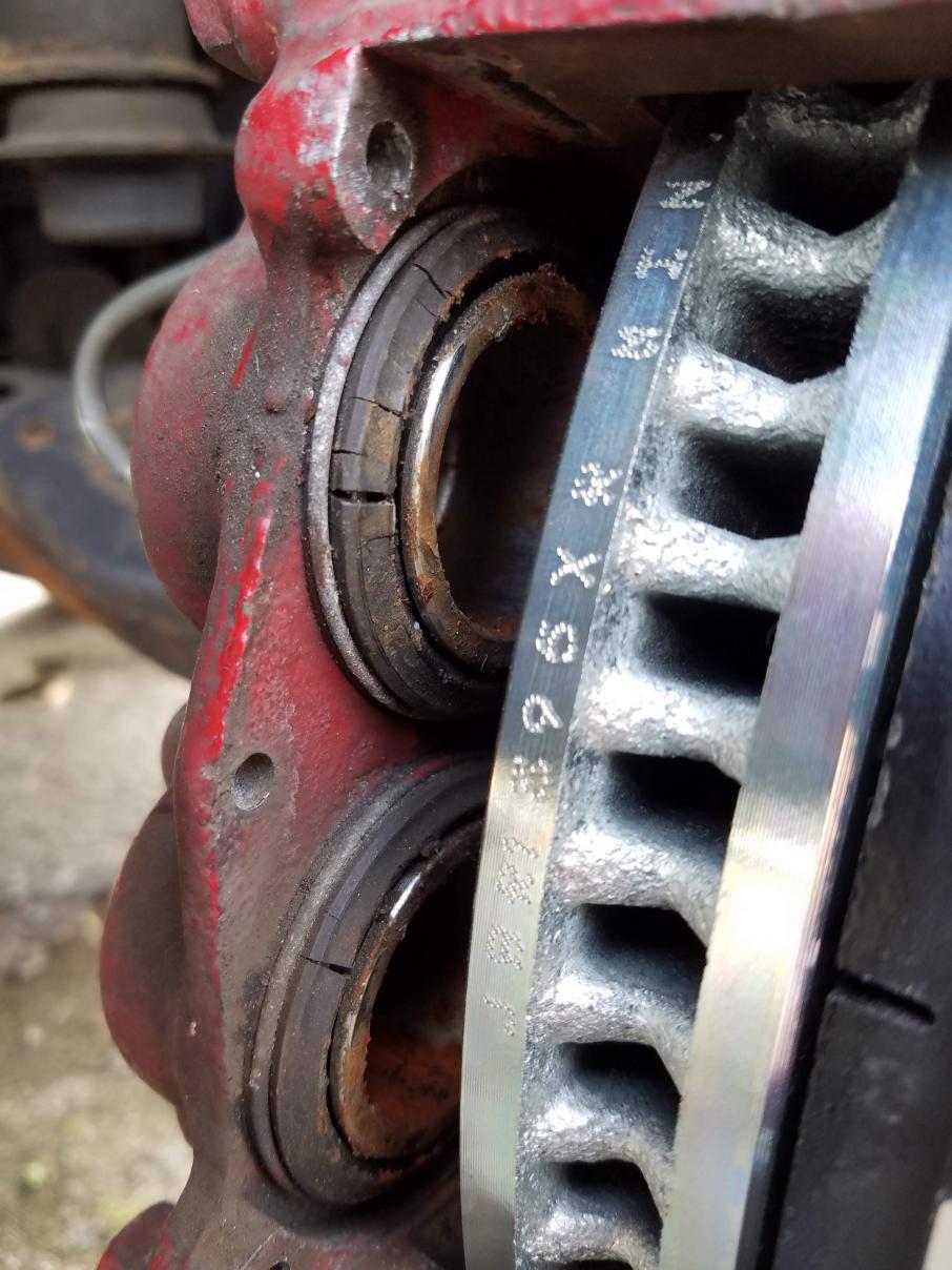

Just wanted to give everyone an update in what i have experienced with Callahan brakes.
Let me give a little history. I have ordered 4 sets of calipers for 3 different cars, rotors, pads and wheel bearings from them. ONE of those was for my 4runner. I had a problem with my Powerstop rotors( their customer service was great). They covered the rotors and pads no problem after 1 year and 4 months. As I was changing them i noticed a problem with the Callahan calipers I changed at the same time.the piston seals were badly cracked. I have changed alot of calipers in my career and never saw this. Even on the bad 4runner calipers i have changed did not have this issue.
So i called Callahan, they said that there is only a year warranty. So I went into my explanation that this is not normal and possibly there is a bad set of seals. Now i realize that i am only 4 months after the expired warranty but this failure is not normal in this timeframe. I contacted amazon where I bought them and they were very helpful and they got nowhere. You would think that they would realize this is not a usual failure and give some sort of assistance or at least work with me on the issue.
Also when i called Powerstop the customer service rep asked if i changed the calipers and I told them I used Callahan and he seemed to know about them. Awhile back I did some poking around and i found paperwork online that showed powerstop owns Callahan.
Just some consumer info.
I twice bought power-stop calipers. Hands down, the worst experience I have ever had. Both calipers leaked right out of the box. Once from the seam line and the other from the piston seals. Very poor QC.
If you go to rockauto, they carry Nugeon calipers, rebuilt in the USA and very good experience. It sucks to have your car in pieces to find the parts are defective.
I no longer buy raybestos or cardone calipers either. QC is terrible.
Those seals are awful for being a year old. My 12 year old OEM ones are in much better shape. Those are a ticking time bomb for a frozen piston since they're letting moisture in. Unacceptable.
