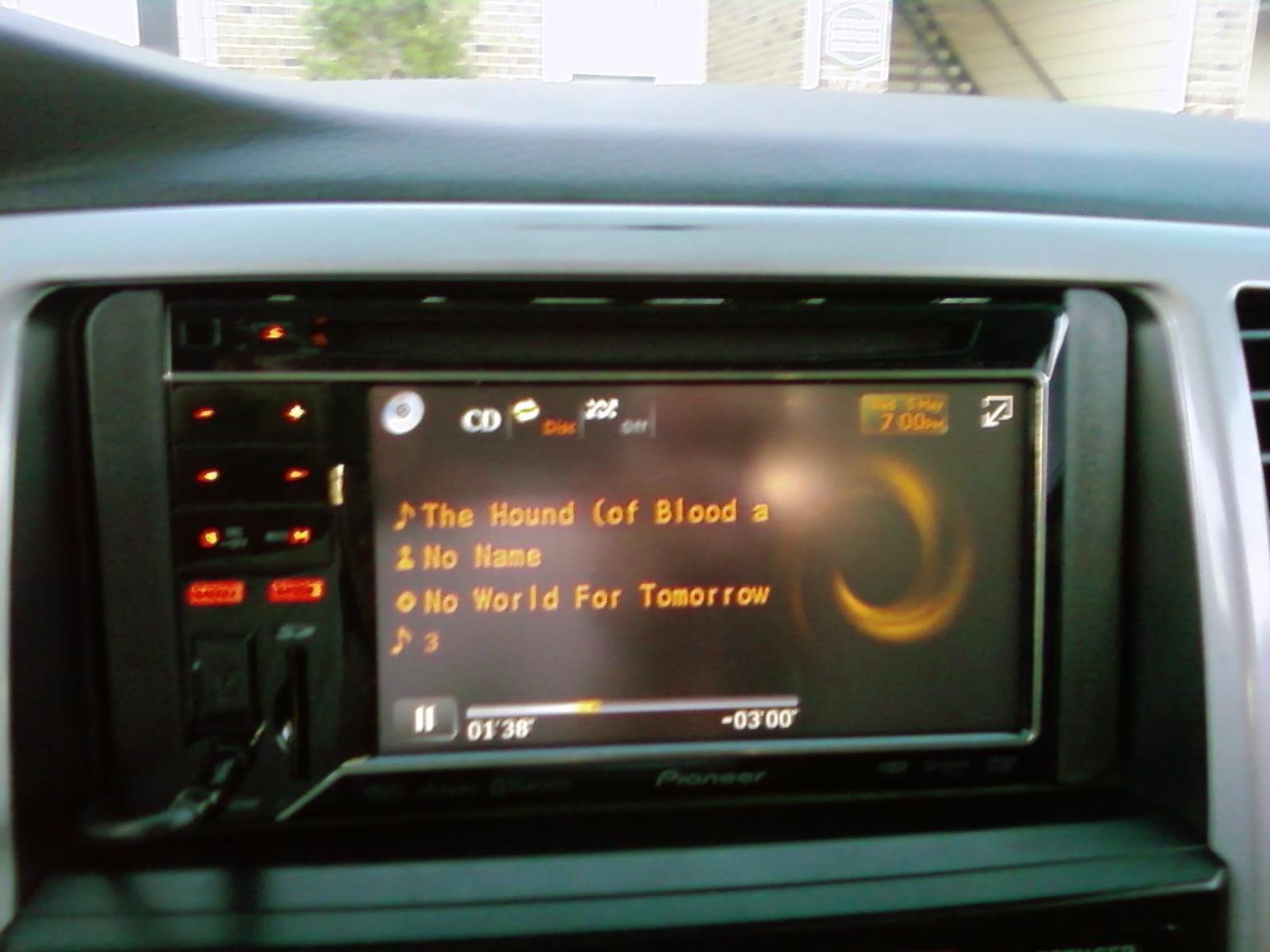

I just got a new Pioneer Head unit model # AVH-P3200BT.... I want to be able to play a movie while driving.... (so wife can watch)... there has to be any easy way, it is just one wire that need to be connected... any one done this?

That's a big pic... Yes, it can be done.
Two steps: 1) get and install a switch 2) wire DVD wire that needs to go to parking brake to the switch.
When DVD is on press the switch and you got movies on the go.
Good luck.

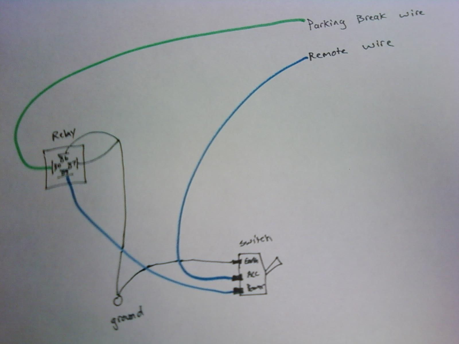

so after about 3 hours of frustration... I got it to work and it is great! I ended up using a switch and a relay. The relay is suppose to delay so the unit thinks the break is on... that would not work right... Added the switch, and I just flip it on and you can watch DVD's and access all of the BT features. Sorry for the blurry pic.

Sorry this is off topic but how did you do the re-label on that switch? Does it light up still? The cruiser guys have a good method (an a whole printable document of good labels for off-roading equipment), but it's for the older switches not like ours.
Strange
Hmm... dunno why you'd need to mess with a relay, switch, etc..
I just grounded the park-detect wire from my Kenwood when I installed mine.
Works for me. :shrug:
I was wondering the same thing. 1. Ground parking switch wire. 2. Watch DVD anytime (disclaimer: Not while driving. Professional driver on closed course. Your mileage may vary. etc.).
The older pioneer decks could just use the ground. I have an old avh-6700 and am able to do this. The new decks won't work with that method anymore. I used a relay when I've installed the latest models out now with this method in this video.
YouTube - avh-p4100dvd bypass
you have to have the switch... the wire has to be hooked to a positive 12 volt wire after you that radio turns on. SO no you can not just hook into a power supply. The relay is there because it gives it a couple second delay, so the radio thinks you are engaging the parking break. The switch is there so it thinks you disengaged then reengaged the parking brake. Pioneer and its new units they want you to engage disengage then reengage the parking brake so you can watch movies, that is why the whole thing is so complicated. Believe me I would of rather just been able to ground it. :)
