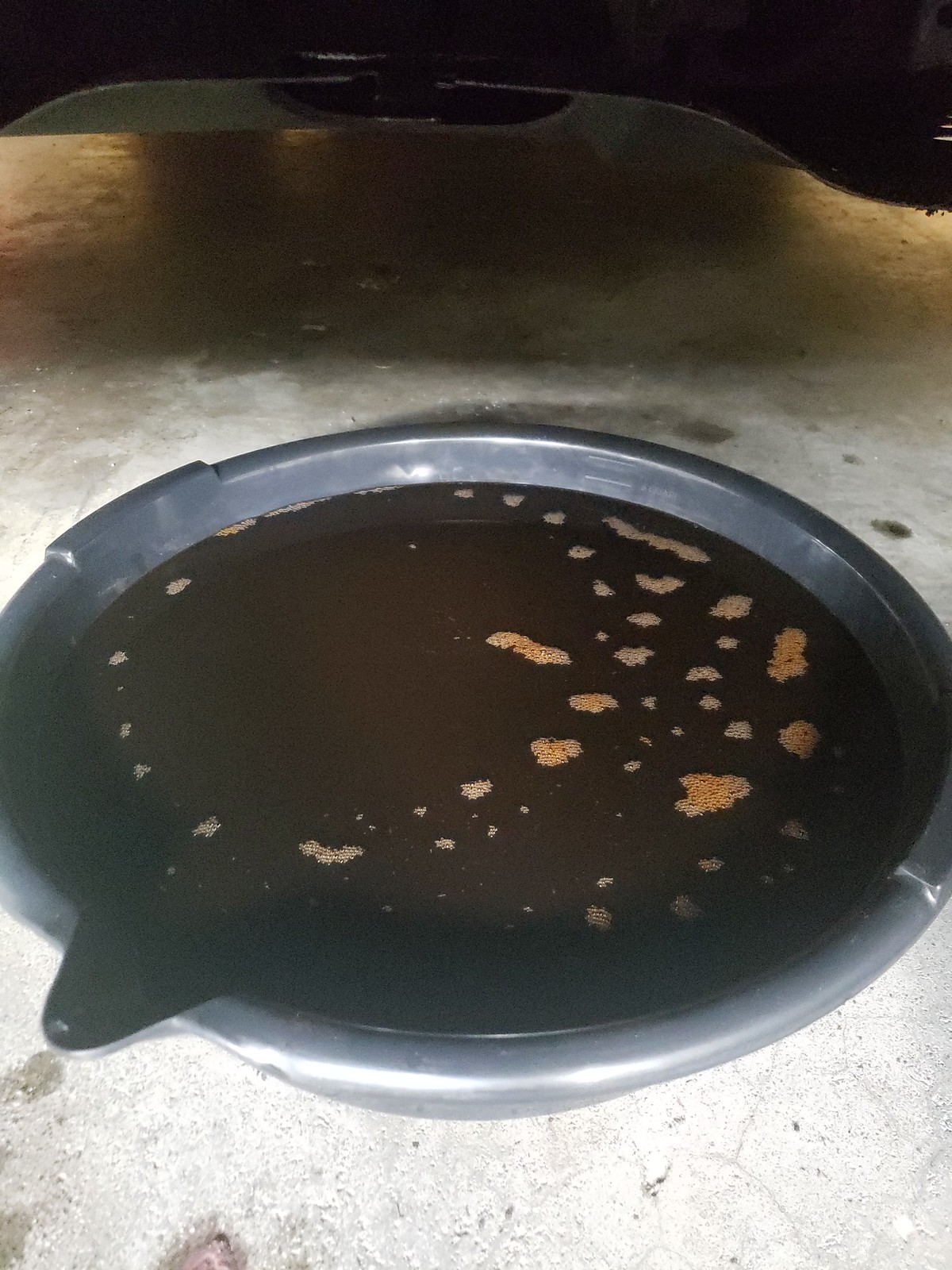

As I rolled over 200k back in December, I went to change the oil in my 02 SR5 and drained a SUBSTANTIAL amount of water out with the oil, see the bubbles in the first pic. For reference, I run synthetic blend oil and change it every 5k. My immediate first thought was head gasket. I took the truck to the local dealer, who actually do decent work, and they pressurized the system and let it sit overnight. Test concluded with them saying that there was NO pressure loss whatsoever. Then I had them do the valve covers while it was there.

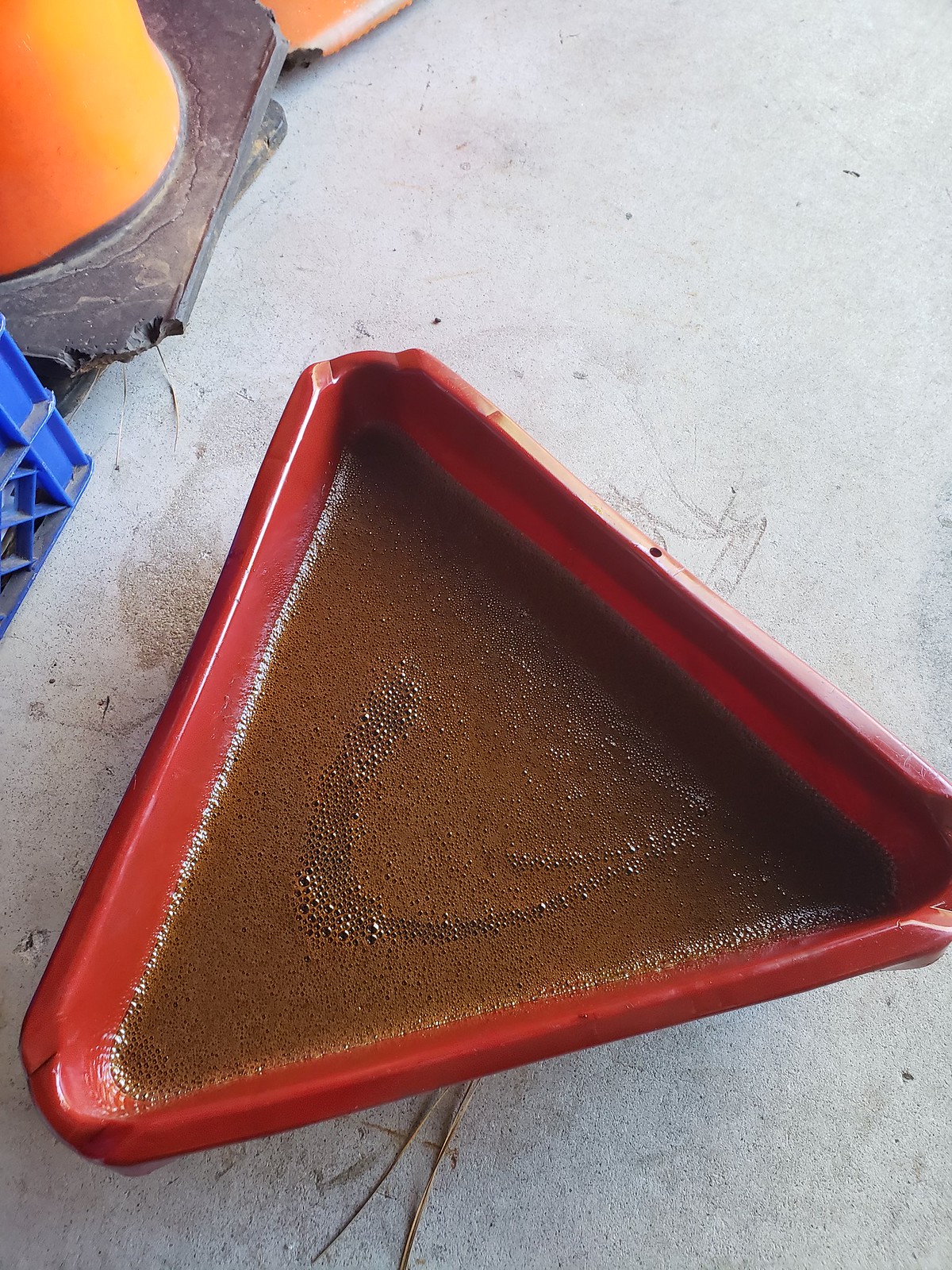

Fast forward to March, I put cheap oil back into the vehicle in December and decided to run it for 1k and then drain the oil for reinspection. There was still some bubbles in the oil, but not near as much. See Pic 2.
So my next though is to do the PCV valve, but I would love to hear some other suggestions.

Oil change at 200K
20190121_120140 by John Smith, on Flickr
Oil after approx 1K
IMG_20190314_101307_01 by John Smith, on Flickr
Looks rather normal to me, meaning doesn't look like water. Many very short trips can add moisture to oil that doesn't have time to evaporate but I don't really see that here.
Now the bubbles could be caused by an overfilling of oil. That causes excess splashing from the crank, might check vehicle is level when adding oil up to mark.
I think it's OK. :cowboy:
Let the oil sit a few days and then slowly pour it out.
The the underside of your oil fill cap clean or full of pudding?
6qt of oil. No more no less at an oil change.
Even if this water comes from a benign source won't it wreck any bearings it comes in contact with?

Once a week you should try and drive it 20-40 miles. If it looks like pudding under the oil cap it’s your oil not getting hot enough to get rid of the moisture.
It is worth making sure your PCV system is operating. No cracked or collapsed hoses and a good grommet in the valve cover and a PCV valve that rattles when you shake it.
Bubbles in the oil isn't a sign of water/coolant as far as I know.

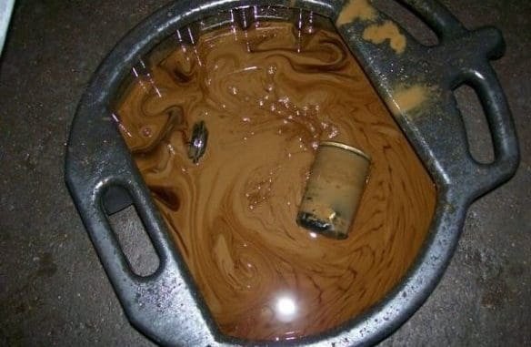

If you were getting significant mixing, it would look more like this:

If your oil didn't look something like phatty"s at 200K It's probably not anything serious. Next time you drain your oil pour some on a cookie sheet that you've heated in oven nice and hot. 300 deg, if it pops and snaps, you got water. wherefrom, keep looking.
I agree that it's not a head gasket leak, it looks more like a chocolate milkshake than a frothy cup of joe. Remember, water is heavier than oil and will sink to the bottom, not float on the surface.
Have you tried a different brand of oil? I know you said you put some cheap stuff in there, perhaps try a different brand. These 4Runners are not picky on oil brands.
I also agree on the sentiments on replacing the PCV valve, grommet and a hose. Also check/replace the breather hose on the backside of the driver's side valve cover that goes to the intake. If either of these is clogged the moisture cannot vent out of the oil. All those parts will not cost more than $10.

I'd replace your pcv, hose and grommet...would've been a great thing to do with the valve covers off as that grommet will be petrified and tough to get out without it breaking off and going into the valve cover vent...and just because the pcv rattles doesn'tmean it works right...could have a broken spring and still rattle...that oil looks fine though...a good run down the highway once a week would eliminate that left over condensation.
