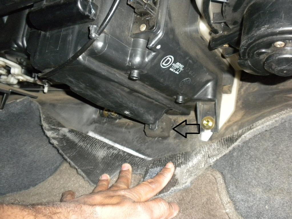

drain line
Drain is indicated by the arrow. IT may be clogged or misaligned.

Thanks! but could you also possibly show me a picture of the drain from the outside from under the yota? i want to try and clean it out but i cant find the exit tube... :(
The foam there is bone dry... What other leaks could I have that is making my passenger floor and rear passenger floor wet? :(
