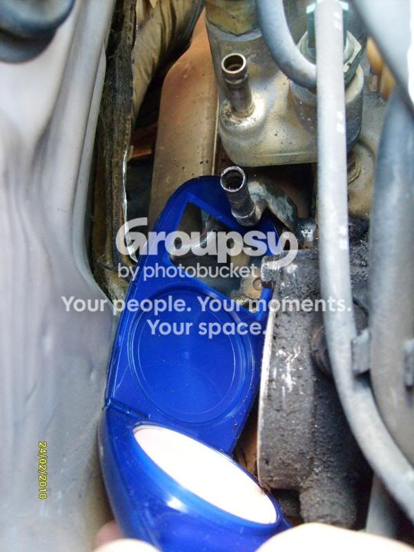

i saw water coming from the hose so i removed it, got a new one replaced it today and found that the hose was bad and the metal nipple the hose goes on has a hole in it. not sure how this would have a hole but its there and i have to fix it.
im thinking the cheapest way to fix it is jbweld over it and pray it works
does anyone know if this is a easy thing to replace or does the intake have to come off to get it off?
this has never been replaced before and was a factory hose.

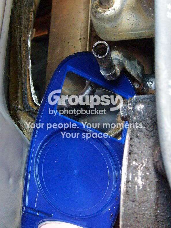

i did put a wire brush on the bottom of the line to clean it off so i can jbweld it so its alittle shinny in pic.
pic of the part and hole below and . this line goes under the cooling sending unit and somewhere i dont know where but i know it looks not easy.

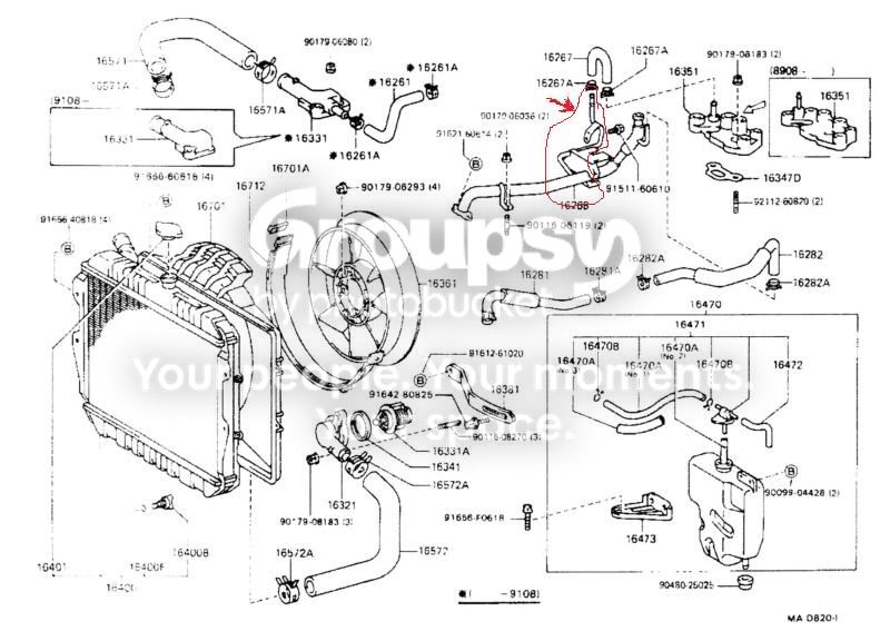

in the parts pictured from toyota there is no part number on this piece, i circled it so you know what it is for sure.

well i went ahead and put some jbweld on it hoping that will fix it for now.
does anyone know how you would get that metal line off if i had to remove it? thanks

that is the #1 water bypass tube for the heater core.I had the same problem.The bad thing is that you have to replace that entire tube and it runs under the intake, changes over to a larger tube that bolts to a water opening in the block that opens to the water pump
theer is a trick to getting the whole tube out without removing the heads
