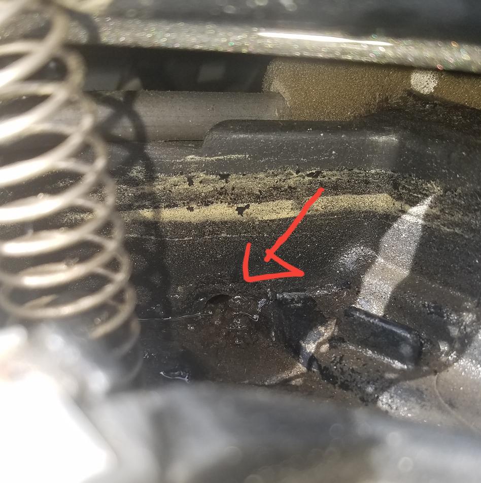

So I was switching the floor mats out today and noticed that the driver side floor by the pedals was wet. They just did the cut pedal recall the other day so I was wondering if they cleaned the floor or something and it just hasn't dried yet. Later in the day I got in it after it had been dumping rain and heard a dripping sound above and saw water in the front of the sunroof. Nothing else was wet and it wasn't dripping into the truck, just the metal in the front of the sunroof and there is no rust anywhere. I did some reading and read some conflicting things about where the drains go. Is it normal the get water up there or not? My last car had a sunroof and I never noticed water but I also never really looked much. Sorry if the picture isn't great, it's the best I could get.

Drain tube for ds is inside the body cavity behind kick panel at drivers feet. Remove the plastic panel and in the cavity behind all the wiring you will find the clear plastic soft drain tube. It can easily be dislodged from its lowest hole thru the floorboard and this will case wet floor. Easy fix with tiny hands to slip it back into place
I had the same problem and got some weedeater cord and ran down through the drain lines, cleaned them all while I was at it. So far no more leaks.

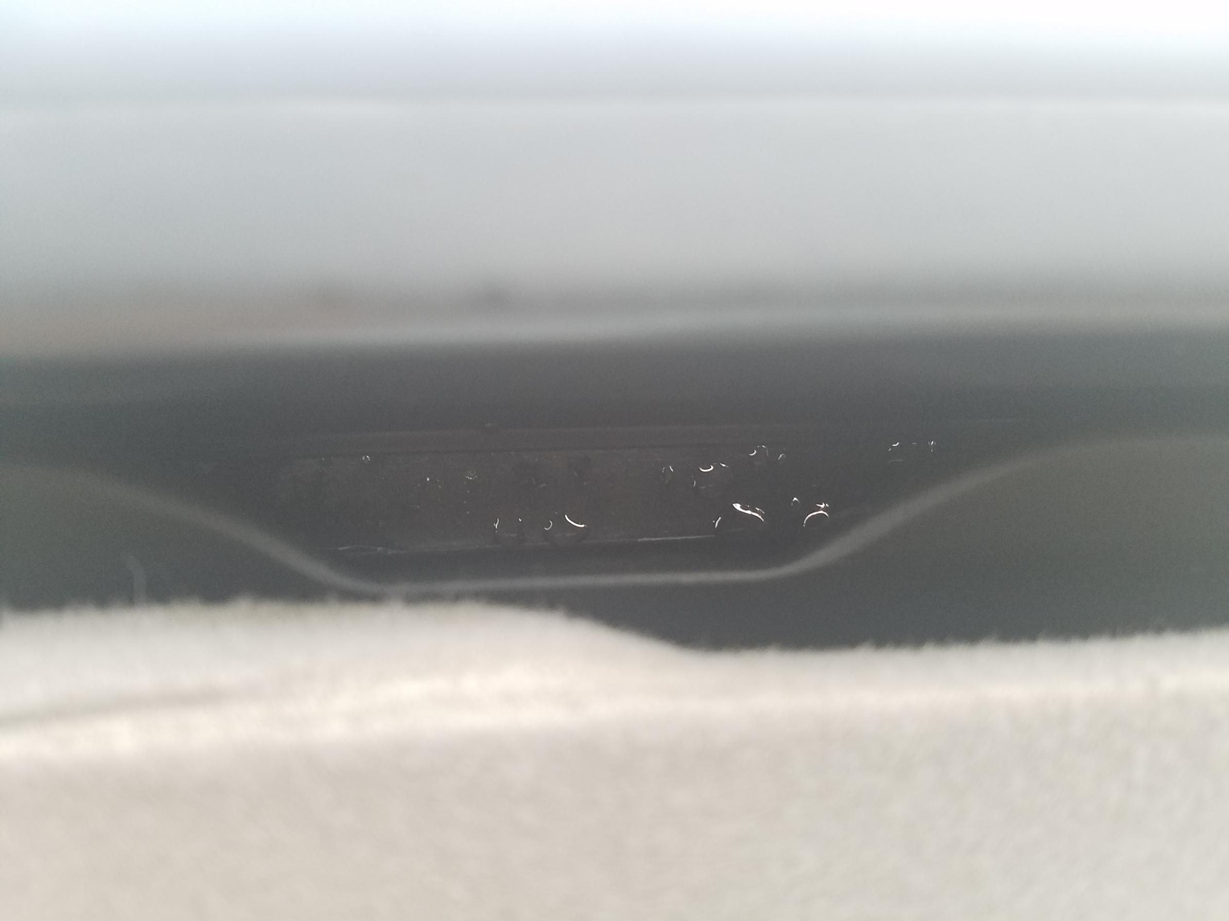

When it finally stopped raining I was able to open it and clean it.

did you clean the exit holes too? and confirm that the tube is inserted thru the cab floorboard? Upper holes get dirty and can clog, but the lower drain hole is the one causing your wet floor
