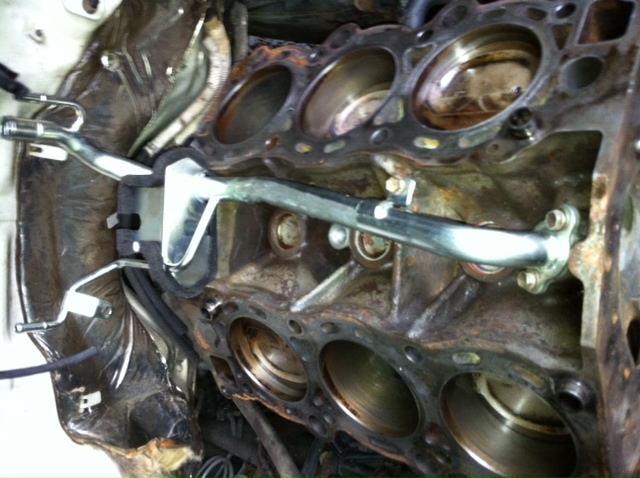

I think mine is coming from the valley and then down around motor.I did not know there were hoses in valley.When I said water or collant,I meant ,it depends what I put in it as to what leaks out.Definitely not ac condensation.I overheated the truck.Probably busted the hose.Can you tell me more about the lines under or around the back of motor? maybe a photo of the hose in the valley if your motor is still out.thanks so much,dave
I believe the water hose you are referring to is called the water bypass tube. I am putting my 3.0 back together after rebuilding the top-end, have actually purchased a replacement bypass tube and am installing it today. I will take pictures and share with you later(hopefully). All depends on wife and weather.
There it is, the water bypass tube under the intake. As you can see, two bolts connect the tube to a water passage in the front of the engine. The other end comes out at the back of the intake and connects to several of those clearly visible rubber hoses. I am only replacing mine because I was questioning how long the original would last. Looks pretty weak to me, corrosion was definitely getting the better of it.

easier way to fix water bypass tub?
Hello I am new to the site. And wanted to know if there was a easier way to fix the water bypass tube? Mine is leaking I have tried a lot of sealers hoping that some thing would help the leak. Because I had thought it was coming from some were else. And then I read your post and said that is it. Also can you drive it with this type of leak? I sure would like some help. Thanks.
