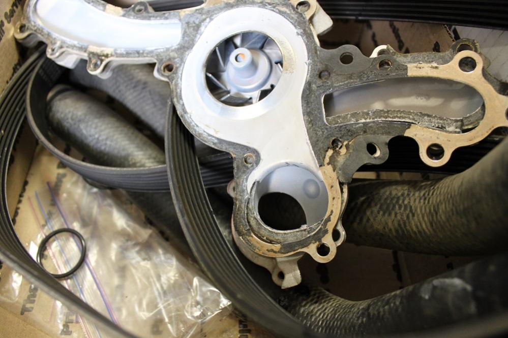

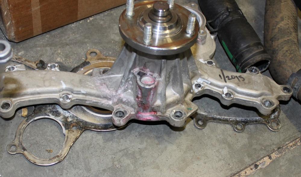

Dont cheap out on the water pump, like i did. Back in 2015.
Bought cheaper, not sure what it was but it was not the AISIN.
Had a paper gasket, that fell apart and glued itself to the engine.
Was a hour job just to get the block cleaned off.:redbrick:
This new AISIN WPT-802 has a plastic like gasket. Thought i snapped a pic but cant find it now.
Thinking back i dont rememder the OEM water pump gasket being so hard to clean off. Seemed like it just pealed off.
