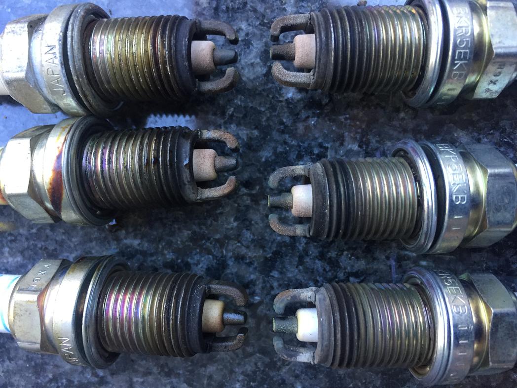

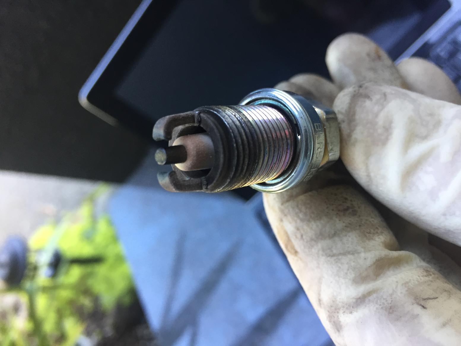

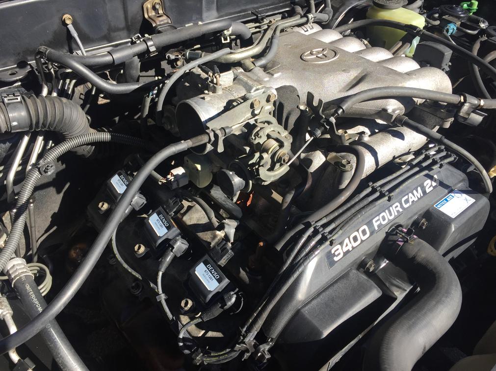

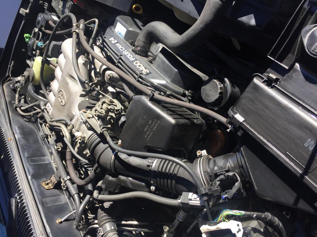

Maybe it was one of the coil packs, the old plugs look way less than 120K miles of use. I'm also speculating that we must have had the plugs changed at some point. Anyway, threw in new plugs, wires, coil packs. It's running solid. Next up? Road test to see if it throws any codes. Plugs inthe picture are:

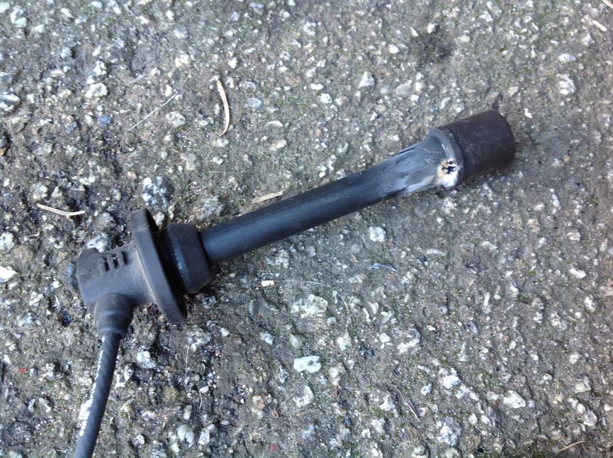

Maybe this was the culprit. #6 plug connector is physically cracked with a hole burned through, as if it were shorting... Whoa. Glad I ordered and installed that "just 'cuz" wires.
