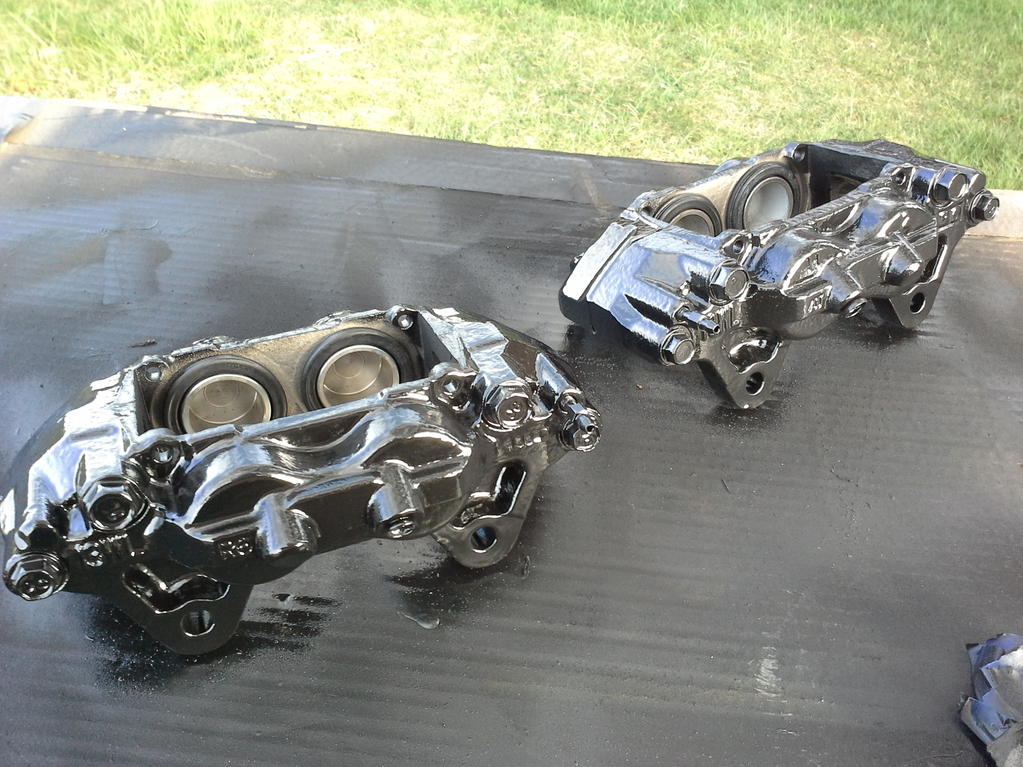

I'll be painting mine with Black Dupli-Color caliper paint. I'll try to post some pictures when I am done with them.
I would have no problems doing the TBU with the AA parts listed. I just swapped the pads on my 4runner with the Wearever platinum pads and I like them. I am pretty sure they are made by Raybestos.
All done painting them! I think they came out really nice.
