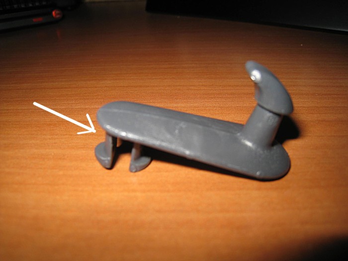

Popping out the floor mat hooks
To remove the floor mat hooks for the driver side front floor mat, I used a flat head screwdriver to put a slight amount of pressure on the end of the hook, where the arrow is in the illustration, and then shimmied it out by rocking it back and forth and pulling upwards. Not sure if this is the best way to pop it out but it seemed to work for me.

so you do have to remove the clips in order to install the digital mats? Thanks for illustration snoop

no, you don't remove the hooks for the digital mats. he has husky, says it in his signature.
