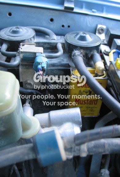

There's a fix for that moo-box, I used a mustard tin I had laying around, some people have used a bigger diameter hose or other small boxes. It just needs a little more air space of your choice is all.

Quite interesting. Is there any benefit to this that I don't know about? It looks like my kind of rigging.
Pretty much just if you want to lose the sound, I think. Toyota actually had a fix for it you could buy but that was discontinued many moons ago. It was pretty much the same deal, extra space in the form of a little box. I'll admit theirs was a cleaner look. :D
Yeah, it makes me laugh a little to see that goofy box in there and happy to re-use something for a cheap fix. It doesn't need to be that big, but that's what I had laying around.
The sound I almost miss. Okay, really just the faces walkers-by made when they got mooed at.
