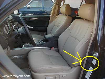

open the door and look on the door pillar below the latch. its covered in a black rubber..
press it in.. the light shuts off.. they wear out over time.. 10mm wrench to take it out.. just pull the black rubber off and you expose the bolt. you can either go to the dealership, or go to the auto wreckers and take a bunch and have some spares . :)
photo... different truck, but you get the idea...
