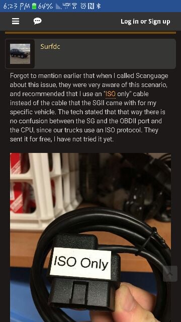

Still searching the webs... Found a thread on ih8mud. This is a common problem and though some seem to think it's not a scan gauge issue it seems to happen frequently with scan gauge devices.
