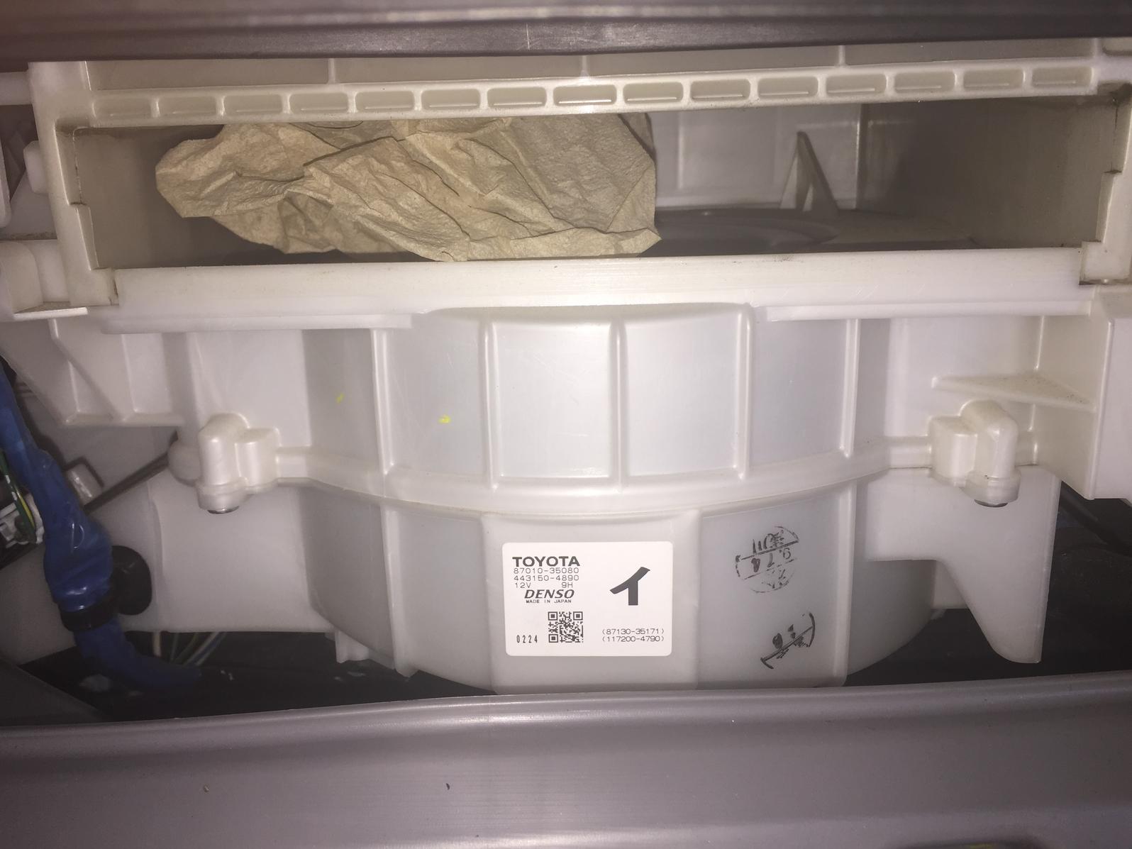

Problem 2 solved and I can't believe I didn't see it when I removed the cabin filter yesterday. Somehow the PO had stuffed a Starbucks napkin inside there for god knows what reason. Removed the napkin and the vacuum sound went away.
