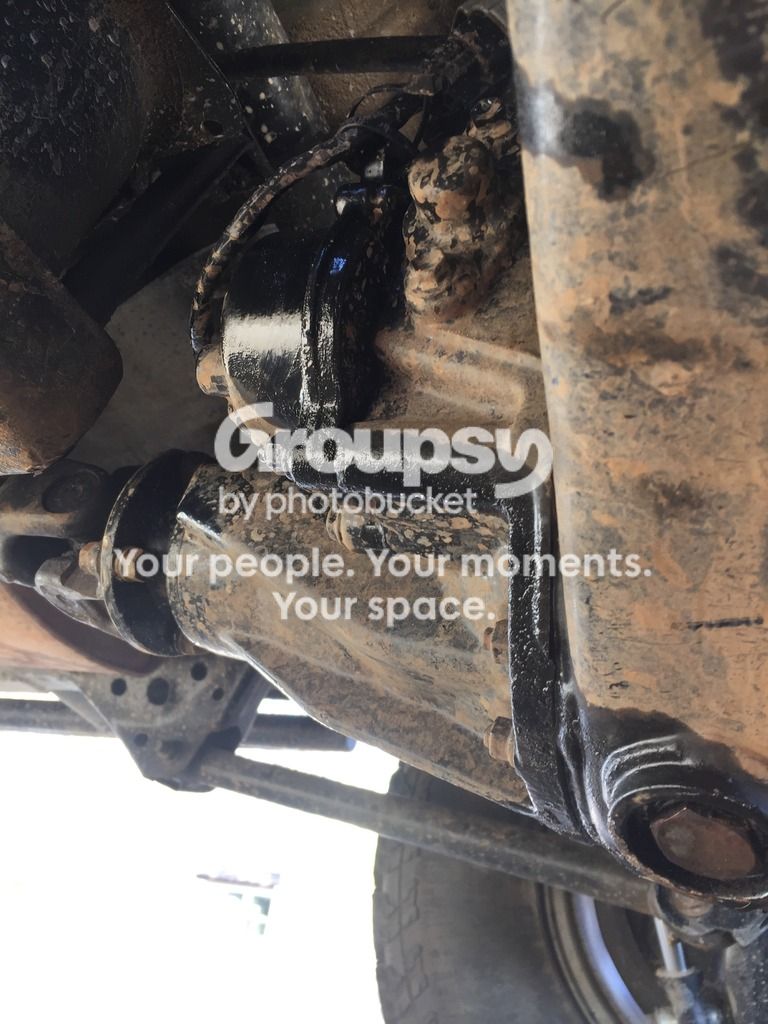

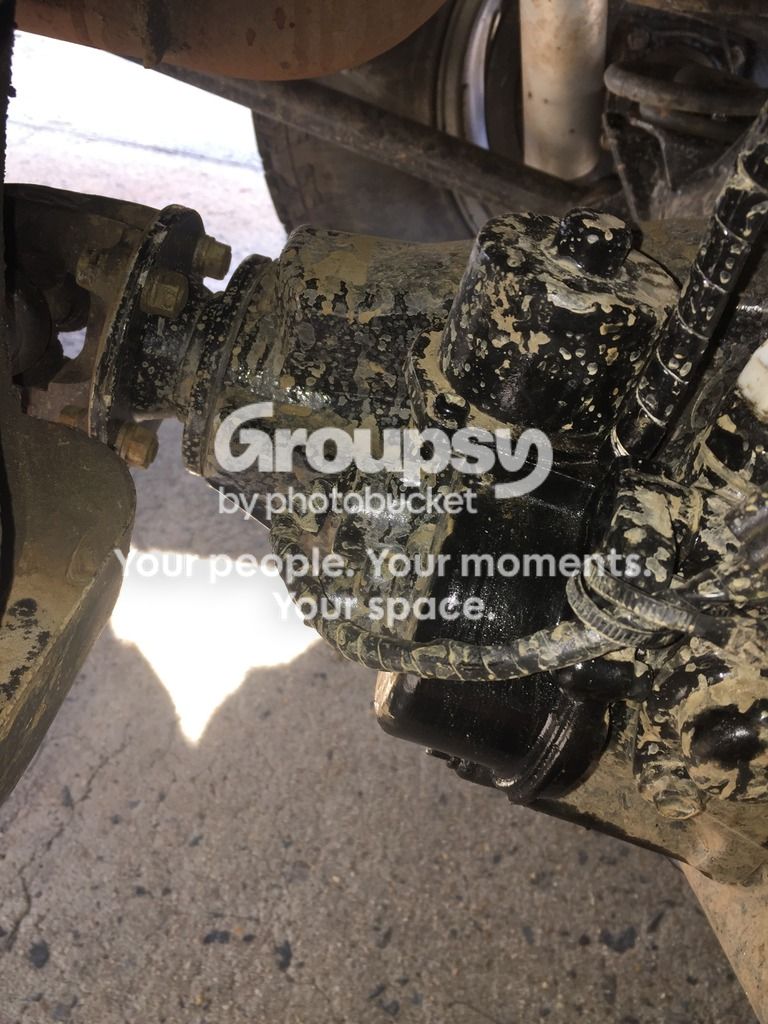

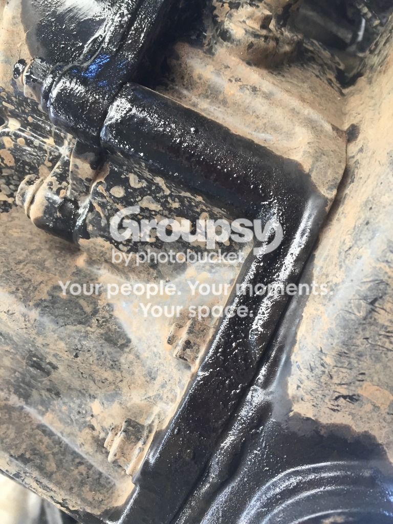

just crawled under my truck and found this.
looks to be leaking gear oil around the elocker. Not sure why. Or what would cause this. Im wondering if this is the cause of the whine noise. Tomorrow im bringing it to shop to get it in the air.
Is there a seal or gasket for the elocker?

I call that a hum or vibration more than a whine. I have not looked at a E Locker other than on pictures and internet stuff. Based on your pictures there are several gaskets and areas that seal. I would say the leak is not the cause of the sound your hearing. Was the rear totally cleaned when you got it because that leak was there before you got it I would gamble.

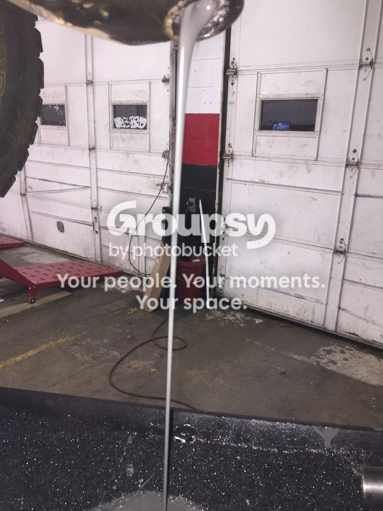

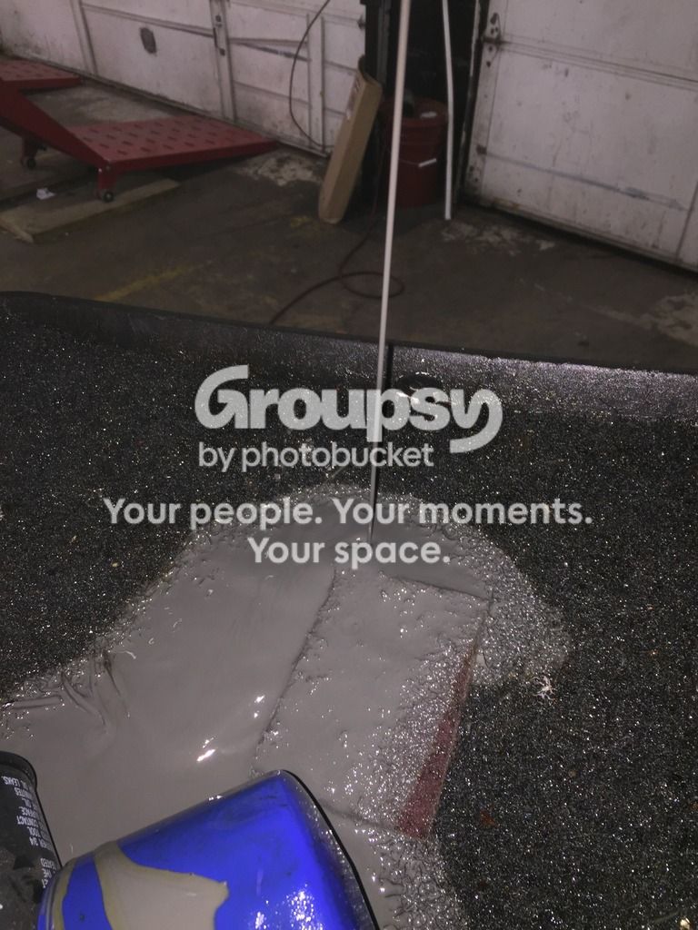

Got it in the air today and in gear. SOUNDED LIKE POOP lol. Basically looks and sounds like the rear bearings inside. This is what the gear oil looked like. I filled it back up 4 times with motor oil, drove it around the parking lot to flush it out. Then put gear oil back in and it is still the same noise
I dont know what happened. When i got the axle form donor truck the old gear oil looked very very clean. I installed the axle, put new gear oil and drove it for a week and now this is where i stand at. Went off roading 2 times. Dont know how or what happened or what caused it.

Another theory. In the pic above where the elocker is leaking little bit of gear oil. I wasn't running the stock little plate that goes over the elocker motor. Thus didn't have that one long bolt installed. Now it looked like it was leaking a little gear oil out of there. But I really don't think that it was leaking gear oil through that bolt hole. Hard to tell and I just don't think so. But maybe because the bolt wasn't there. It did not seal properly the o-rings that the motor has. And maybe on my off-road test, which i went through a big ass water pit. Water go in ? But if water would of gotten in through that then I would say I would have seen a lot more gear oil leaking. Or maybe water seeped through around the elocker motor and into the housing? I will never know honestly. All i know is, the gears are good, and the bearings are shot. But maybe they are shot, even though they didn't break any teeth off. Now I am not a expert, but because everything in there everything is with in a thousand(s), maybe the bearing is or has worn out the gears. Such as, the "gear runout"? or the "backlash"? These things I don't know. As in I am not sure if the bad bearings could actually wear out the teeth on the gears that you will not be able to achieve Toyota's tolerance. I hope not, because gears are EXPENSIVE! and bearing kit is not that bad.
