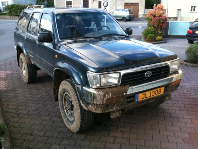

First of, here is the promised picture (no action shot, but still)... I will add more, but I am not really the photo-guy. Which actually annoys me now, as the mods have not been documented...
So, since I have the "jolly green", the following things have been discovered/ fixed:
How about some meatier tires for your forays into the bush?

Yep, those are BFG longtrails T/A´s from the previous owner, those will go the way of the poodle very soon. :)
