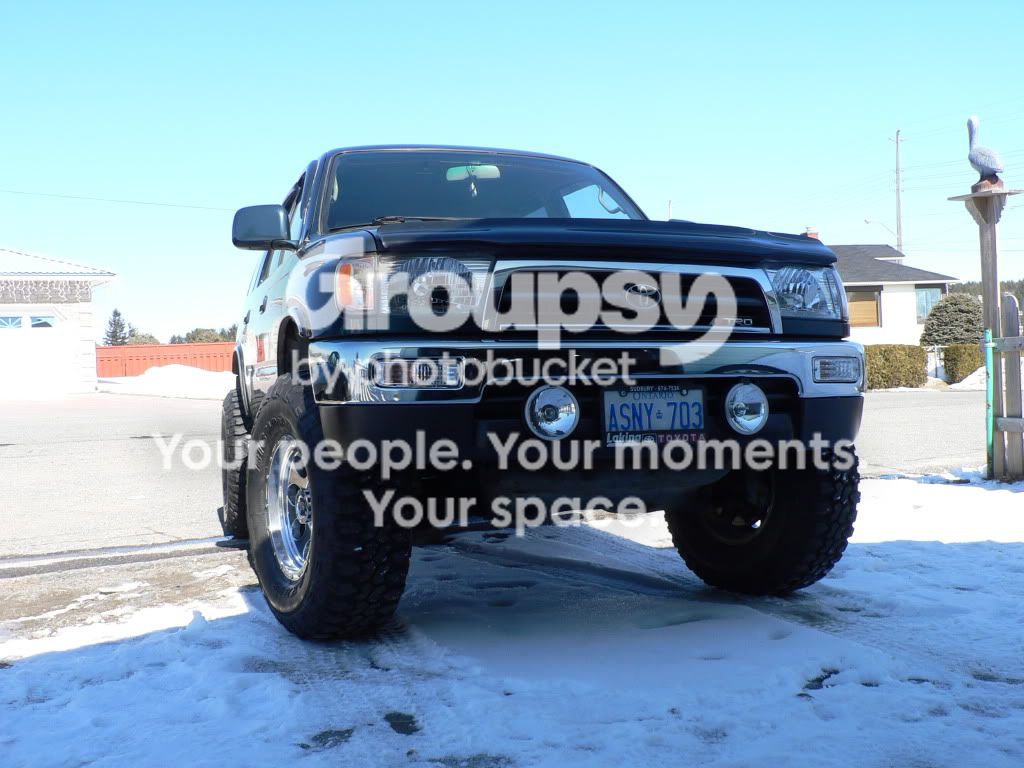

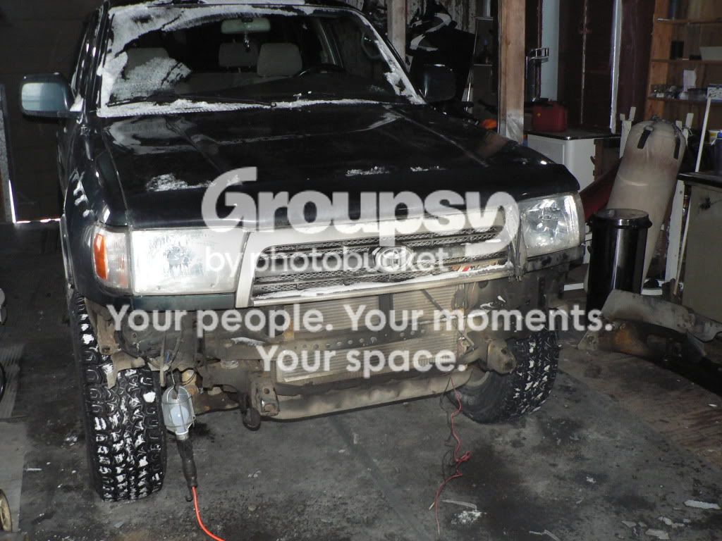

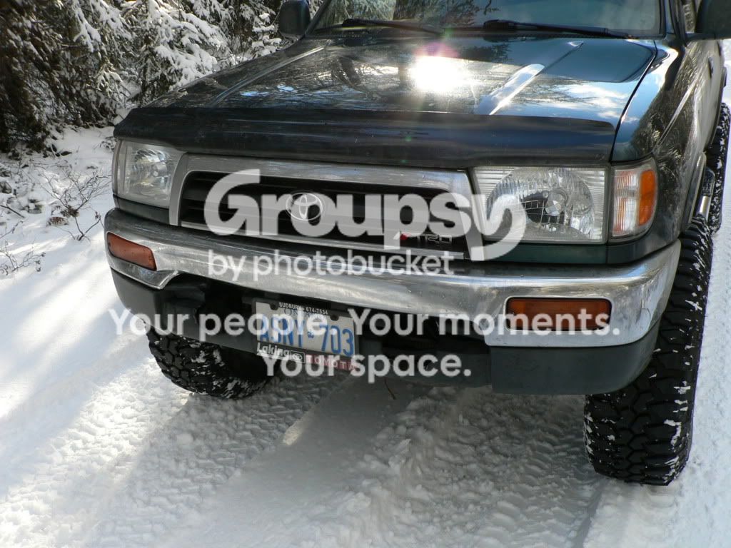

Seriously man, the bumper is a easy job...I did mine this past winter and had no problems. I did mine for under $200.00, but that was including the chrome bumper, new turn signals, 2 tubes of epoxy (to repair my busted lower plastic valance), some new nuts, bolts and washers, and a can of Plasti-dip to paint the newly repaired valance. Not to mention, I paid in Canadian Dollars....stuff costs way more here to buy!
My truck went from this:
P1110630.jpg~original
To this:
P1120199.jpg~original
And finally, to this:
P1120426.jpg~original
I had never done something like that before, and really just used common knowledge of tools and some help from the 4Runner Documentation thingy.....to help me do the job!
