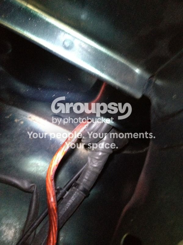

More than likely something like this is your problem:
plug1.jpg~original

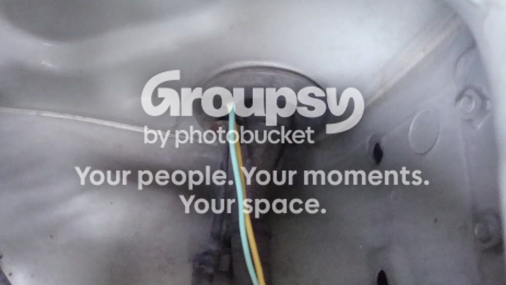

or this:
DSC01298.jpg~original
or this:

Every time I've seen a 4Runner with wet carpet or a moldy smell that was for sale, they all had some crappy Wal-Mart audio aisle crap and they were all fed through the grommet like in the first pic.
I have nothing other then stock wires coming through the firewall. No subs installed or anything that would require putting wires through it. I guess it could be the sunroof. Where are those drain holes?
