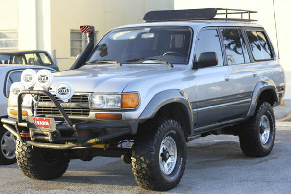

BAM!!! Ultimate camping vehicle

\begin threadjack
Does anyone make a bumper that looks like the one on that 80 series for 3rd gens?
\end threadjack

\begin threadjack
\end threadjack
addicted offroad makes a bumper that looks similar to that one
