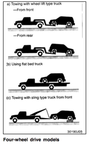

Owner's manual, 1997. This why I have the owner's manual.

If you have to tow 4wd with the axle on the ground. Might be bust to pull the driveshafts. Especially the later years and early years limited. As it seems tow companies do know enough to put the transfers in Neutral.. :/
