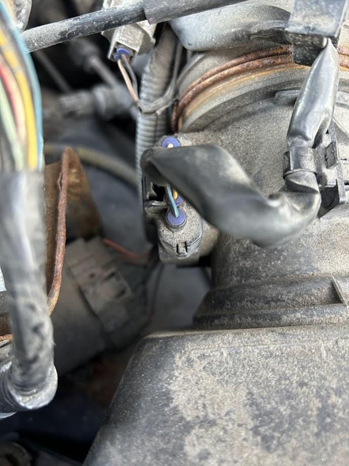

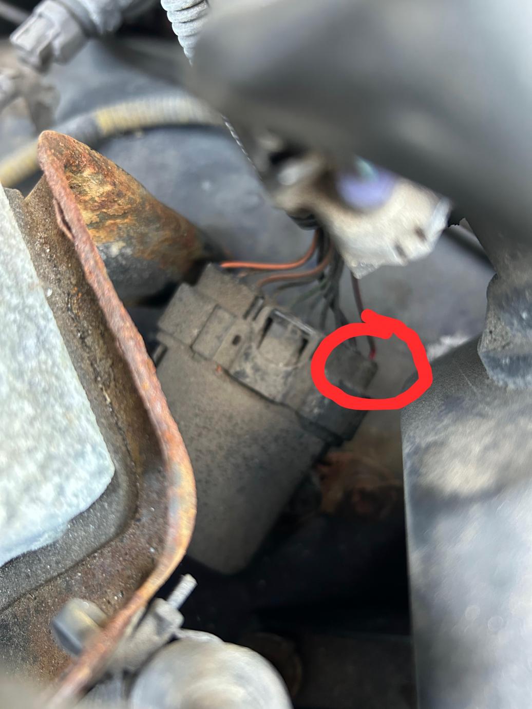

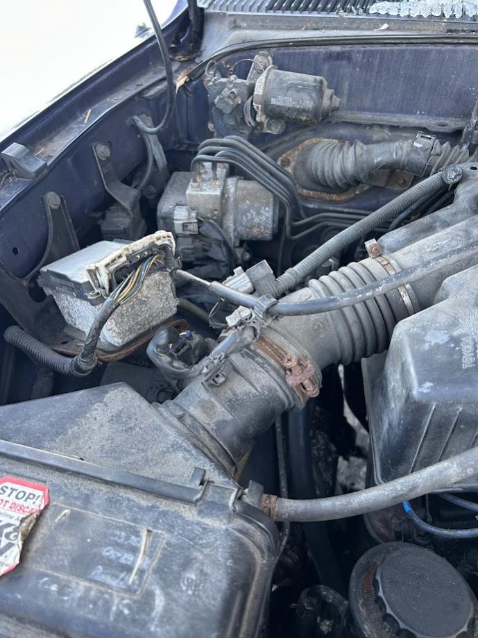

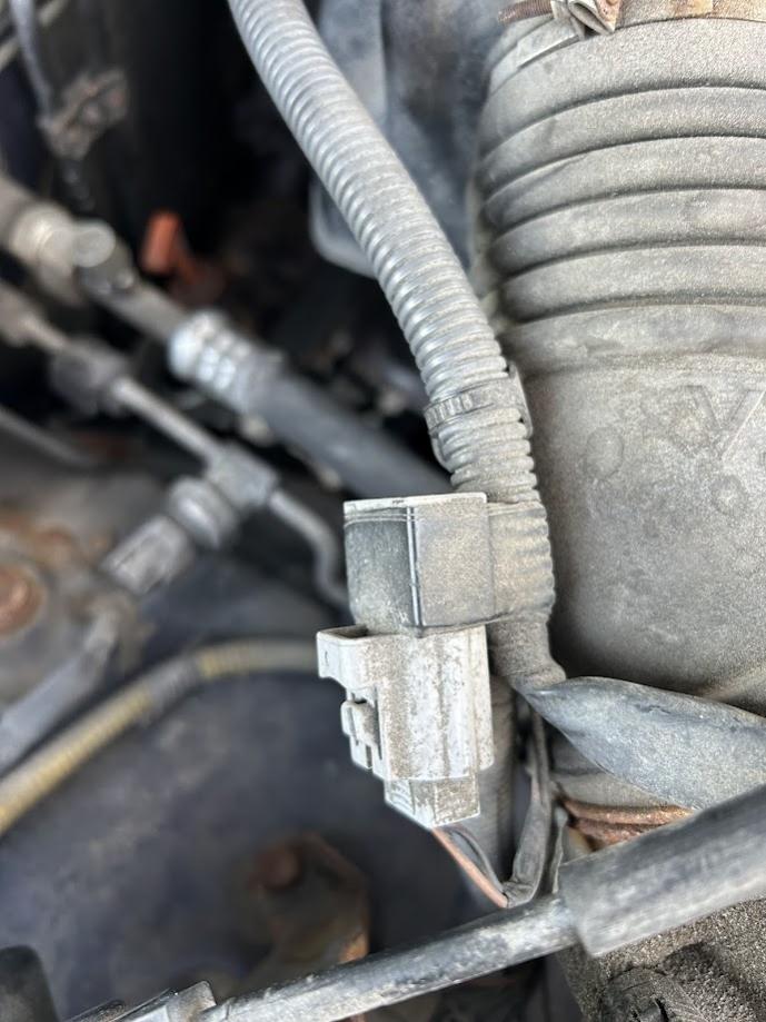

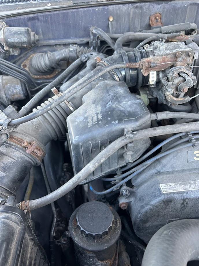

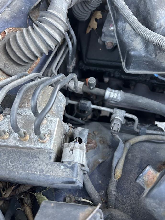

Here are some pics I took. Just curious if anyone sees anything.
My next step is to take out the air box and intake resonator and try and retrace my steps.

So started taking everything apart last night in the freezing cold and looked the wire connections. The MAF connector looked fine then I worked my way down to the ignition module. I started tugging on the plugs with wires and the brown one on the end just came out. I guess I tugged on the air filter box a little too much causing this. See pic below.
I pushed the brown wire in, and she fired up. So still need a permanent fix and ordered a new replacement wire. Will have to take the connector apart and push the old one out.

That's great you found the problem, I suspected you pulled on a wire a bit too hard during your work, that brown wire is most likely the ground wire for the igniter thus causing P1300 code as mentioned in the link I posted.
