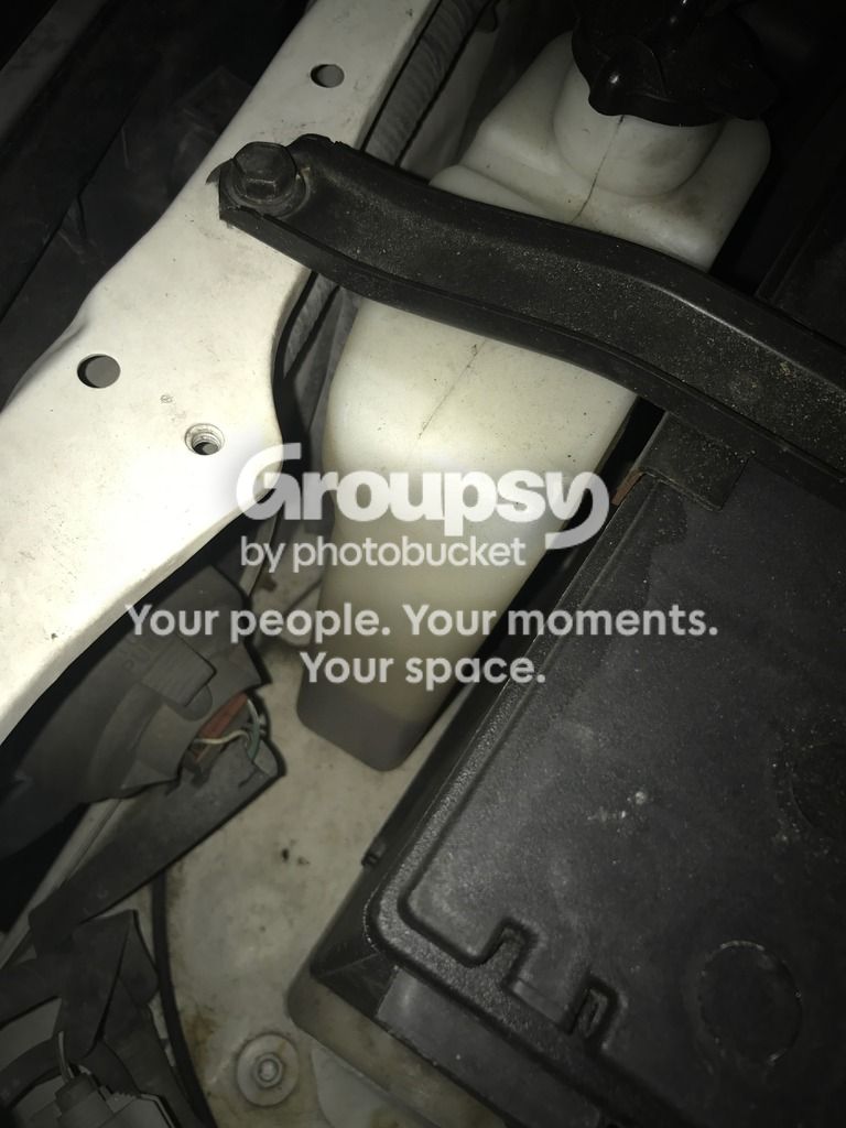

Alright guys -
4Runner noob, I just picked up my rig a little over 2 weeks ago. I'm a total noob/novice when it comes to working on cars. I may read automotive journalism on a daily basis and can talk specs all day long, but when it comes down to it, I do not know my way around a vehicle...all I can really do is change my own oil. The upshot is that I bought this 200,000 mile example knowing that issues would crop up with the intention of trying to learn.
Now for the problem: I've sprung a leak somewhere.
[/URL]~original[/IMG]
Pictured is the front end of my runner...I know it could be coming from the engine bay and leaking all the way down to the ground, but it appears to me that the leak is coming from...whatever part that is in the middle of the axle (this is how ignorant I am when it comes to identifying car parts). I would do a search as many on this forum suggest before posting, but I legitimately have zero idea what part that even is, so I don't know what to search for.
The consistency of the fluid is slick and it smells a little bit like oil, but I don't think it's oil. I can't comment on the color of the fluid because it rained today and mostly washed away. I will report back on that once my runner can sit for a bit and the pool of...whatever fluid it is...can collect again.
One other thing: it looks like my coolant is low.
The transmission is shifting just fine and the temperature gauge is just below the middle between cool and hot, so I don't think this is a pink milkshake issue or anything like that, but for how little I know I could be dead wrong.
Please help! I may not know much but am willing to learn and just need some of you fine individuals to point me in the right direction. Thank you!

That coolant isn't too low. The other side of the reservoir has the level marks for cold and hot engine temp. Just fill with the coolant you have in there already ( green, red etc) to the appropriate level for engine temp

2. That is not your coolant level. What that is, is your coolant blow off container and it looks pretty normal. To check your actual coolant level: remove the cap from the radiator when the motor is COLD. I repeat only remove the radiator cap when the motor is COLD. The radiator should be filled to the top of the cap.
