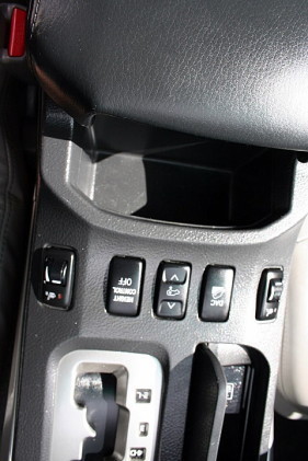

The two on the console beside the DAC switch is for the Height Adjustment (one for turning it on/off and the other for up and down). The two below the dash is: one for RSCA button and the other is just extra (off road lights, another alarm, etc.).
That is the FIRST pics I have ever seen with those switches actually filled! Thank you for sharing.
