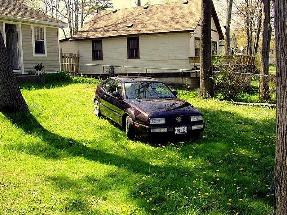

Im giving my vwcorrado the winter off this year so I wanted to grab a reliable 4runner for around $2k-$5k but I have no idea what ill be getting myself into (kind of like when I bought my vw )
