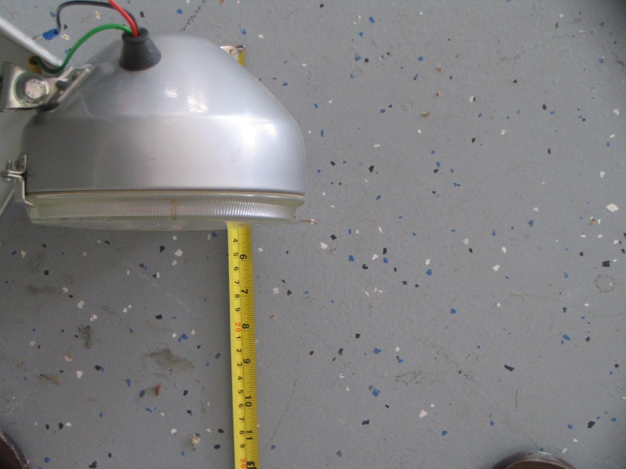

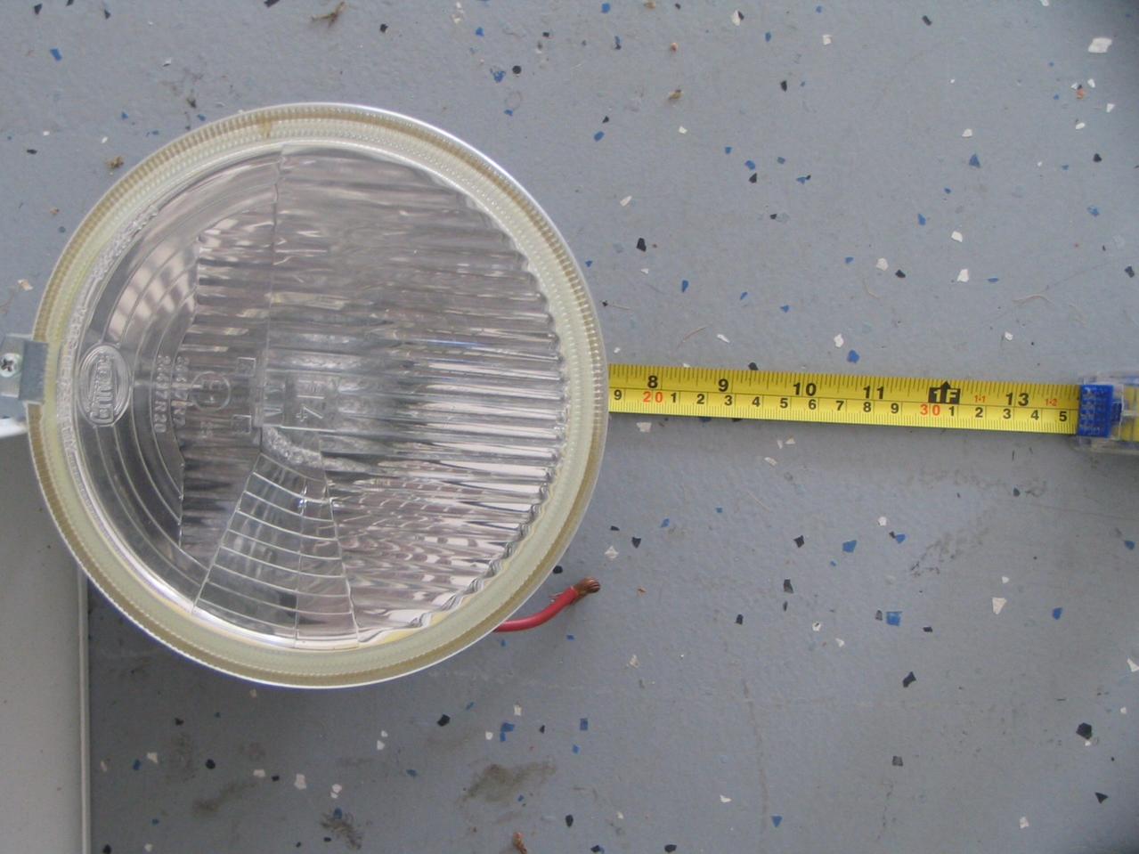

they are for my hella's not sure which model they are here are some pics, all i know is they are an H4 bulb so just figured i would use an H4 HID kit maybe not though....?

did you just want to see the bulb cuz its the same exact bulb that goes in our runner for the head lights, if you want to see the inside of the housing i can take a pic of those, ya they are pretty old probably 10yrs old, got them for free though so don't mind saving a couple hundred if i can spend 60$ and get them working decent with some HID's
o if its the same set up then just get a h4 hid's dont get the hi low ones though id go with like a 5000k or 4500 if u want a hint of yellow
