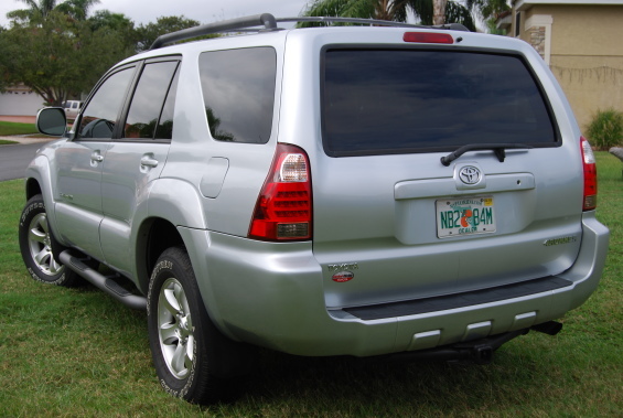

Hi,I'm new(2weeks) owner of my 2006 4runner 4wd SE. And I would like to make some little changes to it,but have no idea if this is possible...

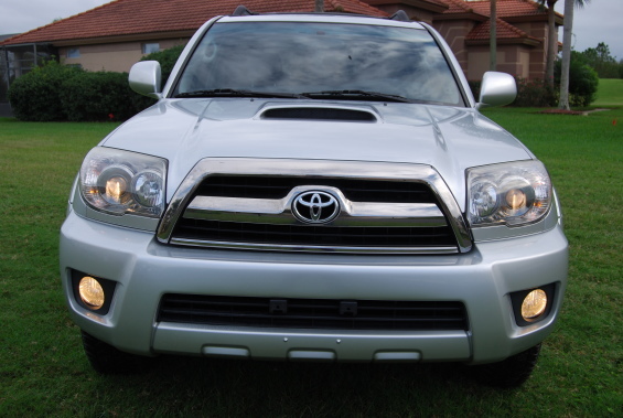

1: Head lights- seams to starting to have a sun damage (slightly on top ), but it bothers me a lot! Is it something can be done ???
2: I already got a spoiler with all the instructions and everything,but I'm a woman and have no idea how to do this staff , so I need some place where can i take it to install and what should I pay for job (if anybody knows)
3: Also - would love to change head light bulbs . Should i buy it on my own,or go some where else ?
Please help!?
And thank you advance!

Anyways, for the headlights, Sand and Polish. I'd do 600, 1000, 2000 grit then Polish and, Meg's PlastiX polish on that. As said, there are many online instructions for it. Search "Headlight Polishing". PM me if you can't find anything.
For the Bulbs, you might want to upgrade to Xenon from XenonDepot for your projectors and Pure White bulbs for the rest. They are on the forum and will provide you a discount.

I changed my headlight and fog light bulbs to Sylvania/OSRAM Ultra Silverstar bulbs. Reasonably priced - often on sale with a rebate. Simple plug and play replacement. Big visibility improvement at night. About $30 pair.
3M makes a kit for polishing the plastic headlight lenses. Mcguiar's does too.
Check Amazon for both - they usually have decent description and ok pricing.

I changed my stock light bulbs for the PIAAs Xtreme White Plus (part number:9005 for high beams and H11 for low beams). PIAA ain't cheap but has good quality.
About the spoiler, if you don't drive to fast, the other cause to install it is to try to keep the rear window cleaner from rain / snow / dust etc. In my own opinion, the 4R looks nice with out it.
RainX has a polish kit to fix the headlights.

1. I would use Meguiar's Plast-X for your headlight lenses.

1. I use this Wolfgang kit from Autogeek for the hazing in headlights.
