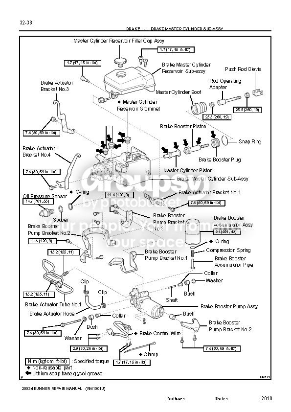

If this was a 4th gen I would say it is the electric brake booster pump. An easy way to check is to turn off your engine while coasting, turn the key to on (but don't start the engine) and press the brake. If you still have power brakes that's what it is, and it's normal.

Here is a picture.....
conponen2copy.jpg~original
4daRUNNER said:
would that be similar to the 3rd Gen too ? i also have a 97 SR5
Don't know that's why I posted a picture. I was hoping someone would look at their master cylinder and see if it has the pump and accumulator, then let everyone know.

that pic is helpfull but the unit I am talking about is on the other side of the firewall.
Glockwarrior said:
So I am not the only one!!!
On the passenger side? So your master cylinder doesn't look like this one?
