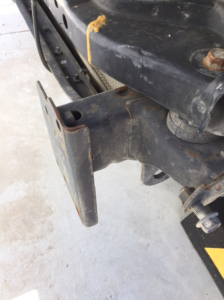

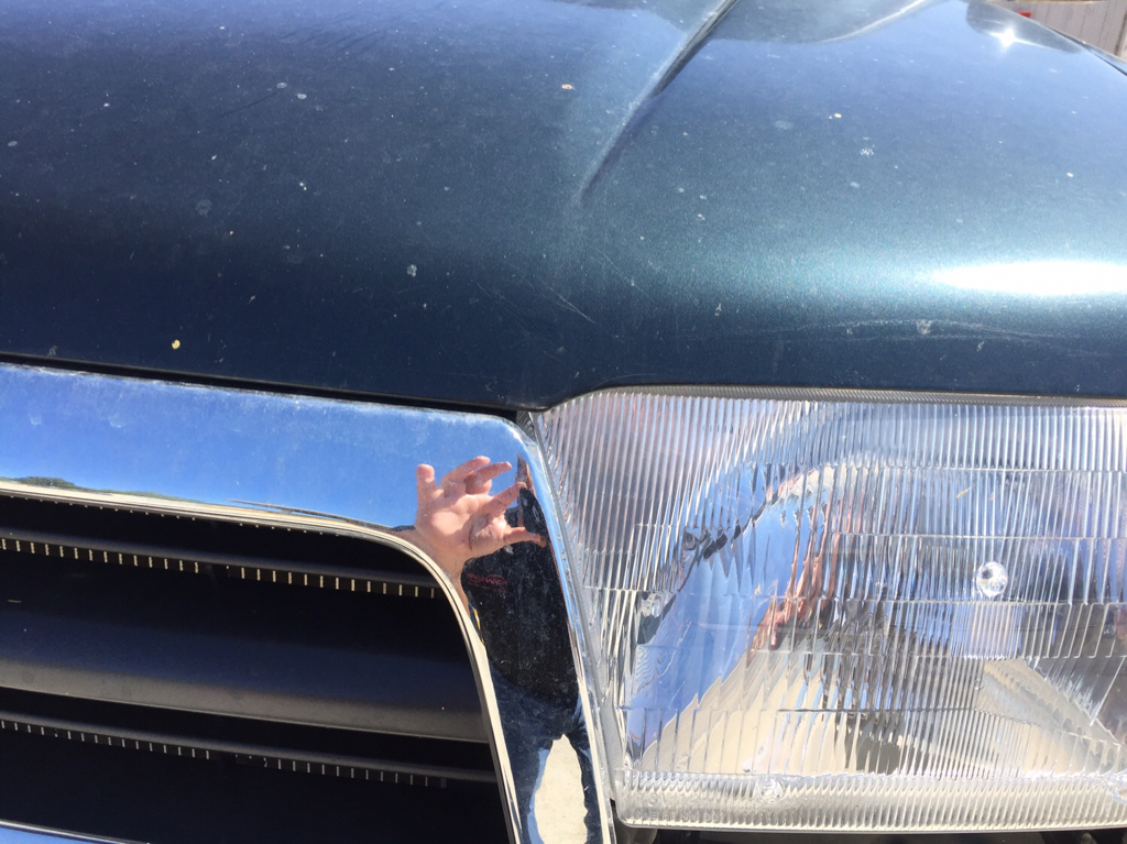

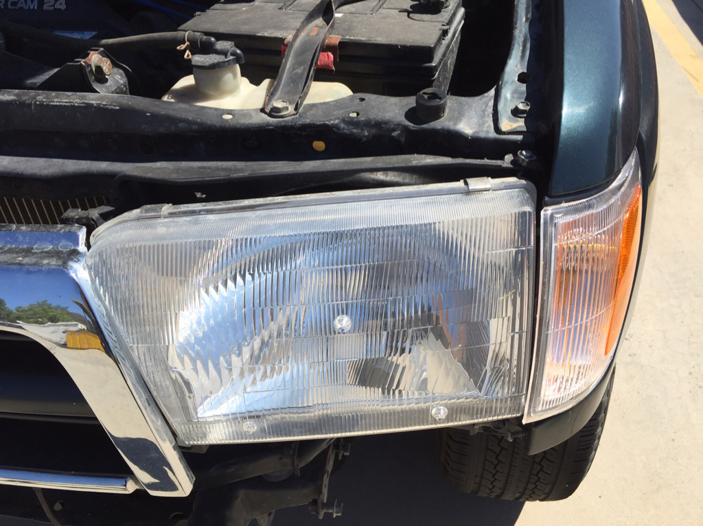

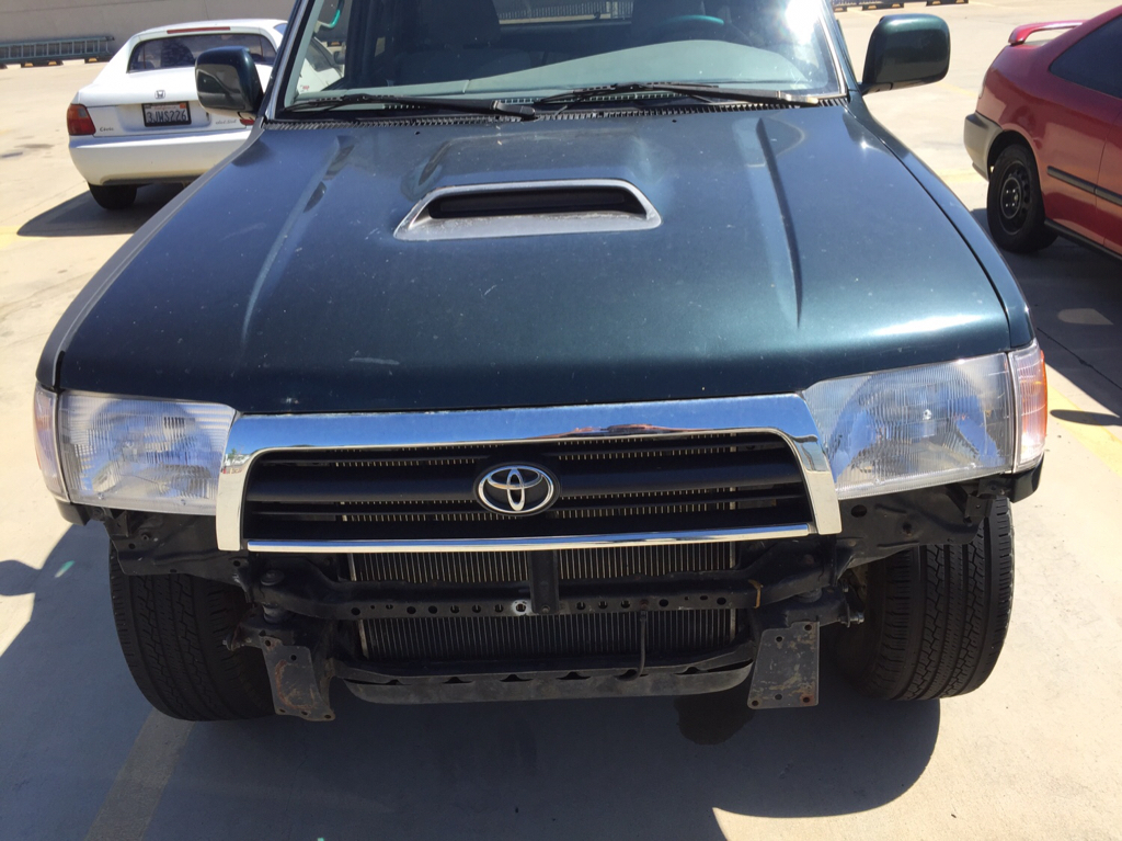

After researching and fixing some issues 1996 4Runner it's looking like someone previous to me put a 99-02 sport hood on it.
I want to replace it because it's dented and I've been replacing front end parts - grille, headlights and corner lights with 1996 stuff. But after looking at stuff the hood doesn't fit right. I assumed it was cause the core support was alittle mangled from an accident before I had it.
Am I right? Can you tell by these pictures?
Will 99-02 grille, headlights, and corner lights work in a 1996 core support? I like the sport hood that's the only reason I'm curious. What's the difference in from 96 vs 99-02 front end parts?
Yes all parts swap with no issues. It's most likely due to damage from the wreck.
Agreed.
You can try realigning the hood by loosening the 4 bolts at the hood springs.
Check to see if the hinges are bent too.
Hmmm... you have '99+ front frame plates too. The front of that truck has some issues.
*If* everything was in stock alignment, all that stuff swaps back and forth between early and late. Grills, headlights, corner lights, hoods, etc.

Frame plates? The vin sticker on the driver door jam say 96
The frame horns sticking out one is bent to hell and the other is straight. I pulled the bumper off.
-Charlie
First thing I noticed. This weekend I sliced off the '96 style plates on my wife's 4Runner and welded on those plates - so her custom bumper would get 6 large bolts holding it on at the front end the frame, instead of a pair of small bolts.
If that's a 1996, then it's had some major frame repair work done to it. Or... someone wanted a more secure mounting spot for a custom bumper... my wife's wasn't wrecked.

Front of the frame should have just little caps, as seen here (my '97 rolled parts truck, one cap is missing)
Maybe some parts were welded on from a later truck...

Frame horns will come off for a custom bumper, skid plate and winch mount that will most likely be welded to the frame vs bolted on.
Passenger side bumper plate looks hacked and welded on but driver plate look stock

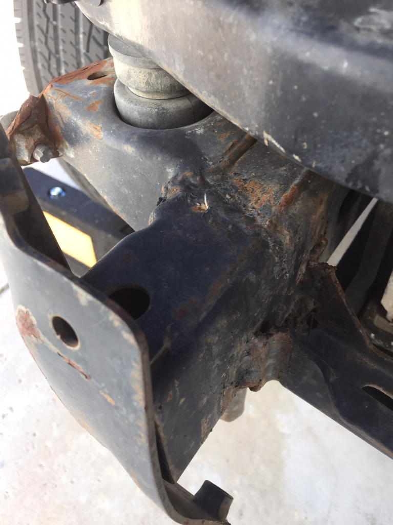

Reviving an old thread just an update...
So I installed my long travel kit and shocks over the last few weekends and began looking at the front end of my 1996 4Runner and thinking about some of the stuff I learned in this thread.
Well it would appear that my truck was hit good and the front clip was replaced like mentioned with a 98-02 front clip. Check out the shotty bugger welds I found on the inner fender supports and the welds around the frame horns for the bumper
