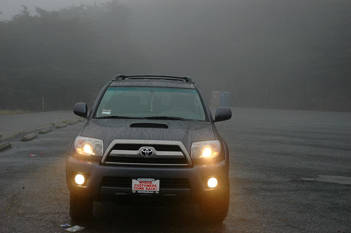

Dude. Let me save you some time. This is the singularly most awesome, smooth power, handling XREAS supporting turn sticking vehicle on the planet. Put down the extra dough ray me and get yourself one.....akay?

This is not a question of cost, more a question of reliability. I can afford the Sport, but am concerned that down the road I might have to shell out big bucks to fix the fancy suspension. That's my only thought. My 86' 4 Runner with 175,000 miles needed a clutch and an alternator in all of the years I owned it. I love the reliabity, but back then the vehicle where much more simple, less electronics and no fancy suspension. So my question is, is it going to cost me major money down the road. I'm sure's its a great system...
ok I hear your concerns. But check this out. This vehicle's stability can out corner many sedans increasing it's safety. If your only concern is the cost of repair my opinion would be to buy a vehicle that has no repair record. If you want a superb machine which is SAFE then buy this one.
