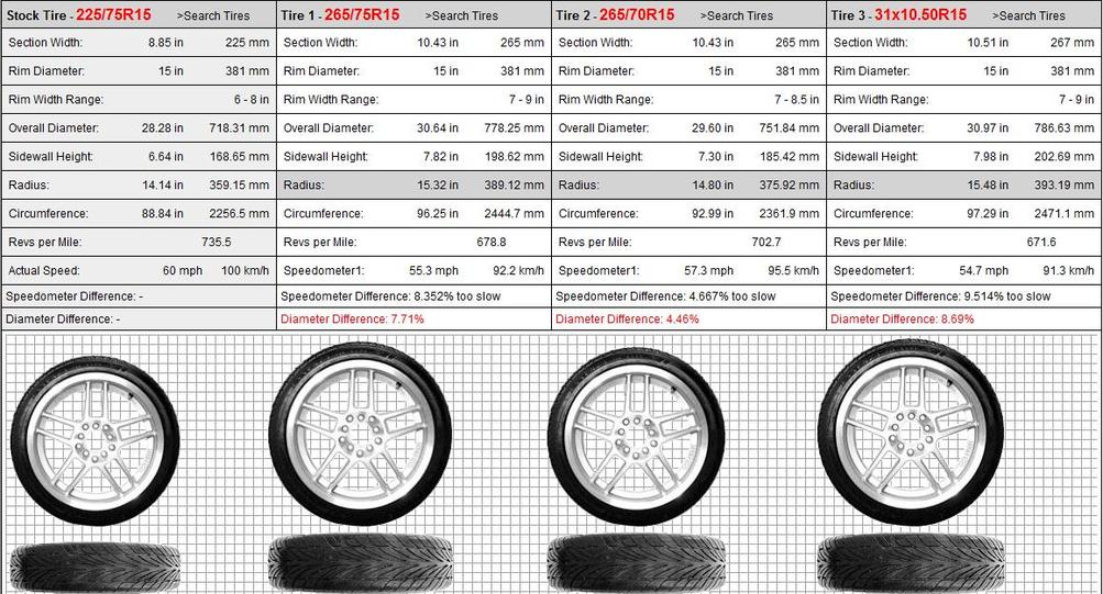

Alright guys, I have been looking all over this forum for people who have the same stock rims and tires as I and are looking to upgrade. Without much luck I decided to use this tire size calculator which gives me the run down on which tires I would consider upgrading to. Anyway, here's a screen shot of the results I got. Lemme know what you guys think! Thanks!
Currently have: 225/75/15's
Posted are the tire size choices I've been researching.

so your not gonna get bigger rims?
Not right away, it's gonna take me some time to save up for rims. I usually only have to pay for half the amount of the tires, because I normally get them for a birthday or Christmas.
Think I should wait and get a set of 16's?
yea bro, i'd wait until you have enough money to get the rim size you want and then get tires for it. you will save money that way and not waste it on tires you want use for much longer.
