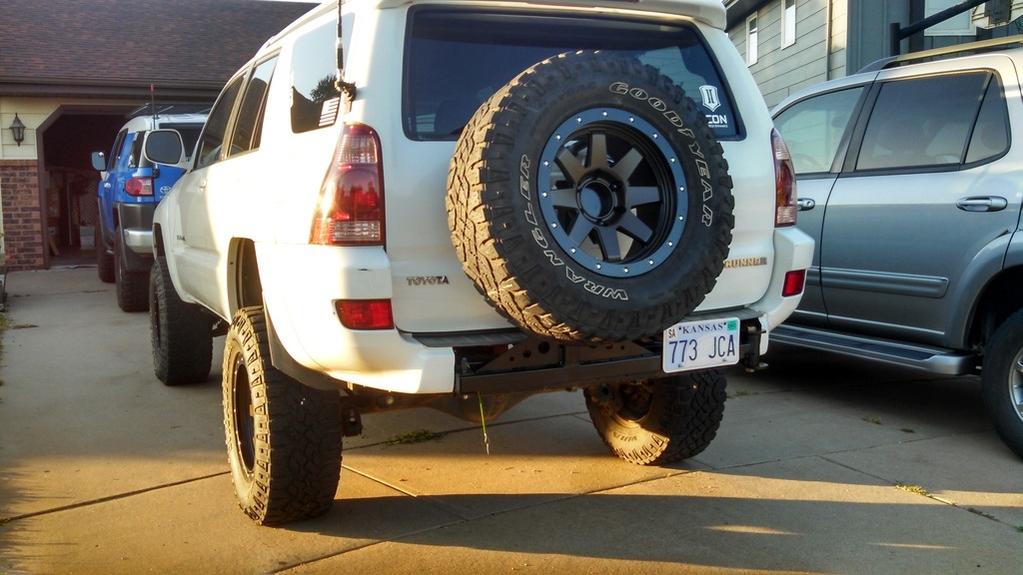

Is that receiver mounted, or is it mounted directly to the frame? I love the idea of finding something that mounts to the frame using the existing hitch mounting points, but can't find anyone who makes them, especially for a 3rd gen.
I run the Detours Knucklebone. It came out to $307 shipped. Folds down 40 degrees so I can still open the back and get the sliding tray out most of the way.
Believe he sells it where it'll go 90 or 100% down, as well as swing out. Goes right into the hitch, tightens from the inside to prevent shaking. Only downside if you want to use your hitch, such as the Wilco versions do, there isn't a connection at the end of the carrier.
its mounted/welded to the frame, any shop should be able to do this. BTW its not my rig

This is exactly what I've been looking for! How much of a gap is there between where your tire sits and the hatch?
It honestly depends as you can choose that. The top of the carrier is adjustable to allow up to a 40" tire setup. It uses a retaining bolt system to allow that, which is one thing I was hesitant about, but to get around that I just drilled my bolts the whole way through and then welded them, as well as welded the sliding "plate" to the carrier as well.
While he said there was definitely nothing to worry about, I'd rather just have piece of mind.
Here's the only real side view I have. I'm running a 285/70/17 setup.
It looks good! The only thing I would have to worry about is lowering it into the front of another car if I needed to get in the back. I live in a city and street parking can get tight at times.
Depending on the car you should be able to clear their hood. Obviously if it's another SUV you would have issues. Also keep in mind it's going to cover your camera if you need that to help you parallel park.
You're still able to get the window to roll down with the key, so if it's something like a couple bag of groceries you should be okay. Anything like a TV you'd run into some issues.
He does make a swing out, though I think you'd still run into the issues of that too in the city.
