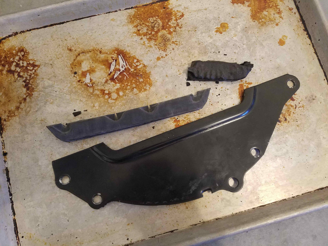

There is a black cover you can remove on the front of the bellhousing and look inside (with a mirror, super awkward). The flex plate is somewhat open to the enviroment so you could actually have a small pebble rattling around in there. I replaced the cover's gasket thing on mine a while ago which had disintgrated, the bellhousing was full of crud.
