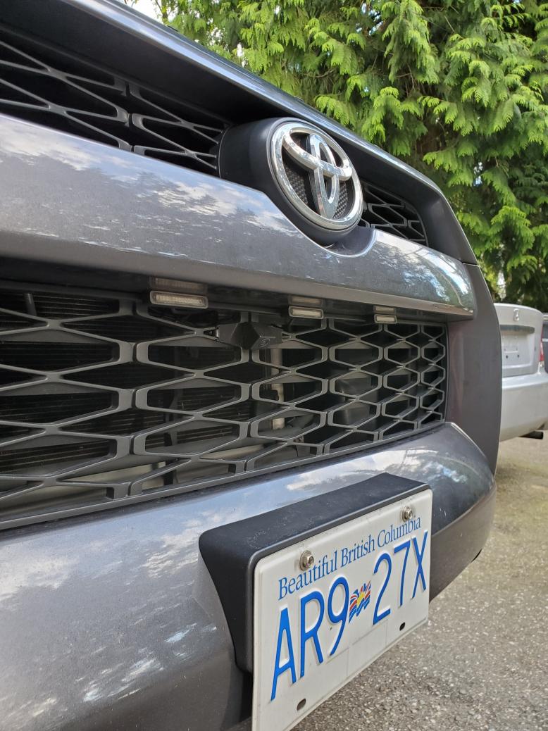

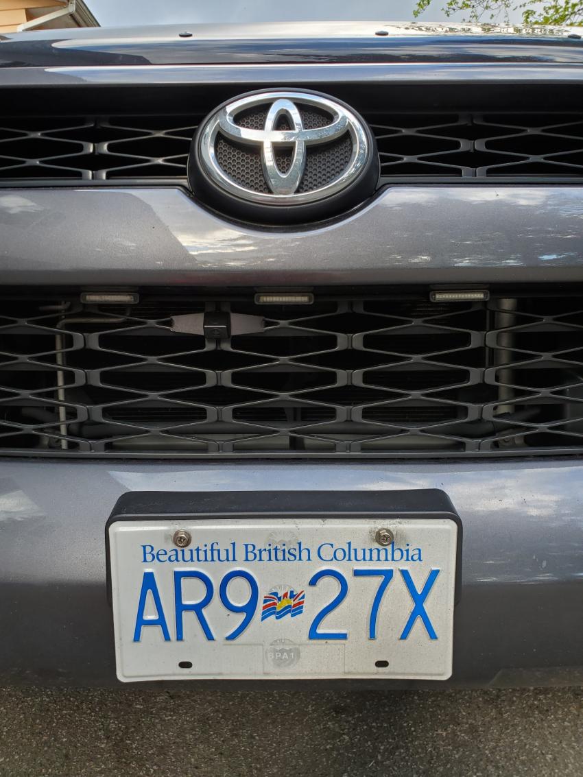

I went with the BEATSONIC CS6EP. Not cheap but thought it was the best one. Plus I think the other options are in the same price range as well. Out of the ones I researched it was the only one with programmable settings. But you need to buy your own camera. Mine is installed on my grille as I didn't want to drill any holes anywhere. Here are a few more options.

Here are a couple pics.

Hey emmantik, very sano front camera installation. Did you fab that mount yourself, or do you have a link to purchase it?
I got the bracket from YOTALEDS. I had to file down the bent ends a bit but fit pretty good. I wanted to mount it dead center but the bracket is made for the smaller grille openings. You can probably fab up your own bracket if you have the resources - I didn't. Here's a link.
